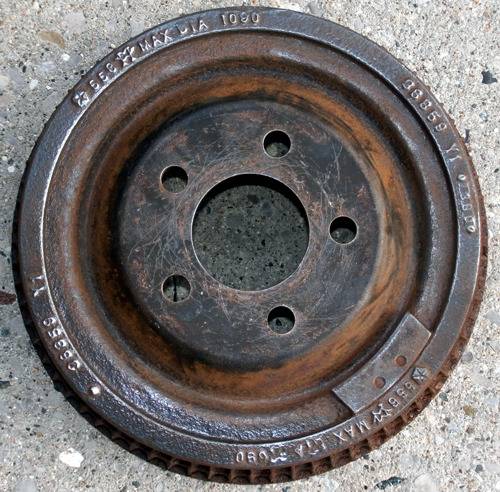

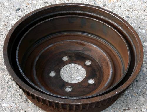

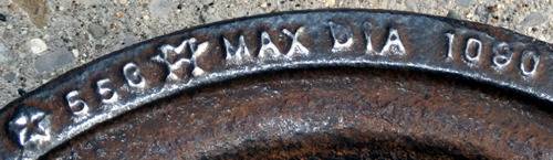

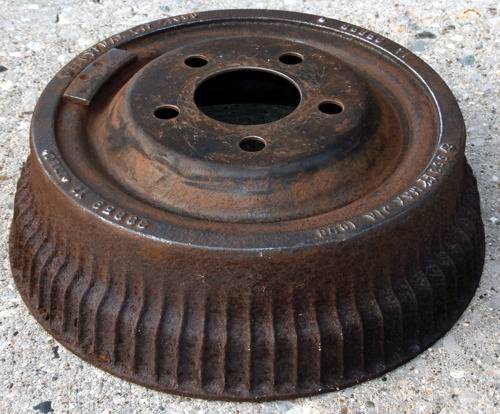

I am going to have my rear drums checked, see if they need machining. This is one of them - seems pretty beefy, I don't know if they're the originals:

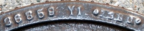

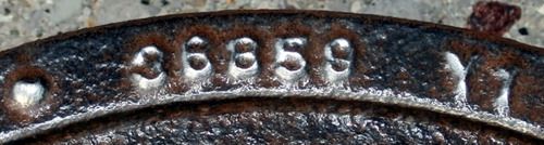

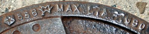

Can anyone ID these? They weigh 8 kg (17.5 lbs) but strange thing, one is about .9 lbs heavier.

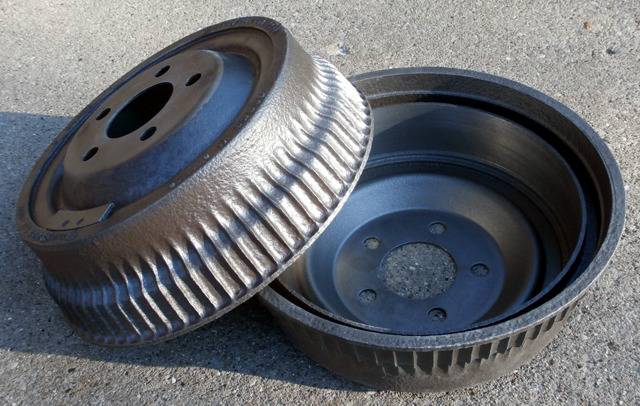

But, here we are. Turned, and shot-blasted (or shot-peened?):
They're 2.5% (200 grams) lighter now. The width of the friction-face is pretty much 6 cm (2.36") so these are not 2.5" drums - they are 2" drums. But they're finned, which I'm guessing would not have been typical for a slant-6 or 318 car? It's totally likely these are not the original rear drums on my '67 Monaco, if that's the case they would have been acquired back in '87. Would a pick-up or van have had 2" finned drums?
$ 113 CAD (tax-in, or $80 USD) for the blasting and turning at a local machine shop (no garages around here do this any more).
Some of that - I don't get. They're talking about full-size (C-bodies) up to '74 having 2" rear drums? Really?
But it looks like my drums really did come from a d100?
Rockauto is showing Raybestos 2955R as being "Rear, with 11in x 2in brakes" and is available ($50). Also seeing DYNAMIC FRICTION 36540007 as being 2" and is available.
BUT - they show those as application 1969 and newer. They don't list those particular (and AVAILABLE) 2" drums for anything 1968 or older. Why?
Assuming your rear axle assembly is stock, it could have 11 X 2", 11 X 2 1/2", or 11 X 3" rear brakes. It was based mainly on engine size and the use the vehicle was made to do. Lower horsepower cars usually had the smaller brakes and high horsepower and many station wagons had the big ones, as well as most tow packages. As for interchange on the 11 X 2" brakes, they ran from 1965 to 1975 on C-bodies and '65-71 on the D100 pickups. They made both smooth and finned drums. Replace them as a set however as the heat dissipation rates were different and can cause the brakes to pull to one side once hot. To change to wider brakes would require matching backing plates and some hardware. Here's a few factory part numbers to maybe help in a search....3004746, 3780525, 2530308, 2823816, 3004932, 3549843. The reason for all the different ones were not only the fins vs non-fins, it was also the supplier. They were made by both Motor Wheel and Kelsey Hayes. Probably some superceded numbers in there too.
