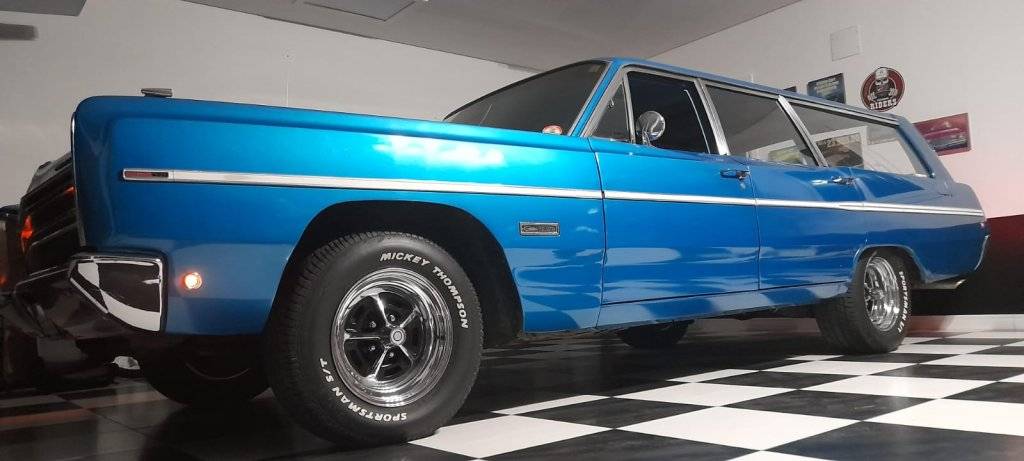

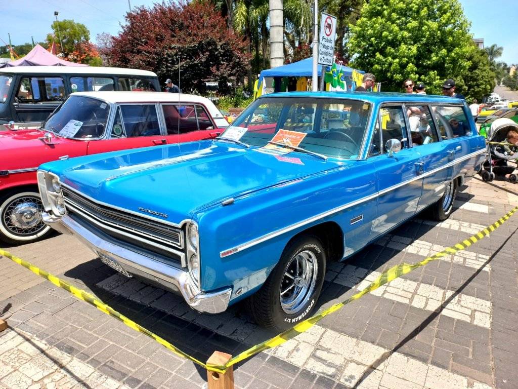

If helps, my '68 Fury wagon is wearing 275/60-15 on 8" wheels back and 225/70-15 on 7" wheels front. Tires never touched the car.

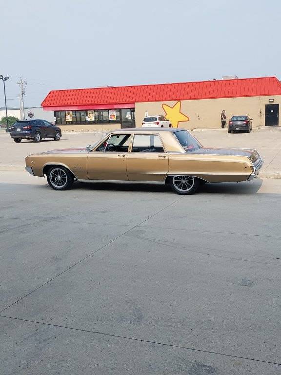

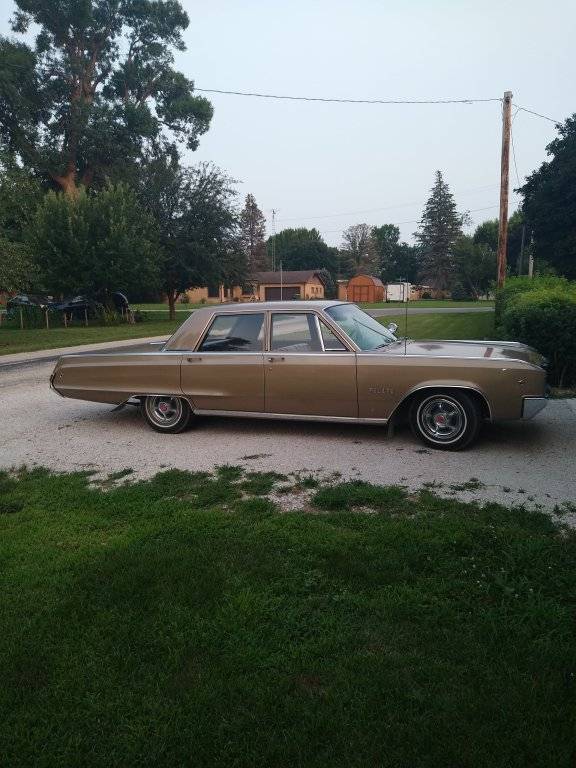

I just put new 17x7 wheels with 235/45r17 on front and 245/45r17 on today. 0 offset which is about 4". Wanted to change it up a little. You guys got first look. Before and after pics

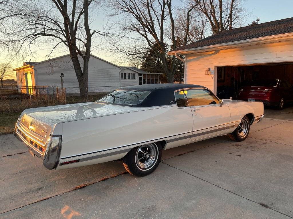

old school vintage from the 60's 15x8.5 torq thrust on my 67 , but i've changed out the rear end to a 67 b body to handle there 1.25 pos offset , 225/70x15 on the nose and 245/60x15 on the butt
