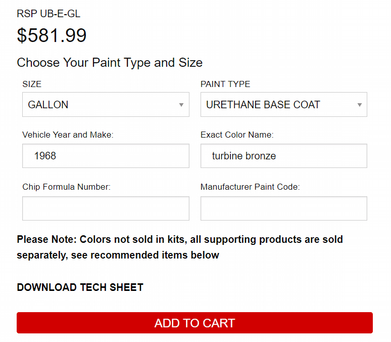

I did some cursory checking out on that site and the first thing I have to say is "WOW" I had no idea paint was that expensive lol! Actually, I did have an inkling because I've heard people talk about it being expensive but I wasn't quite prepared for the reality of $582 for a gallon of basecoat LOL. But it is what it is and after all the hours and hours I've been putting into it I'm not going to go cheap at the end. With this place, are the people at the other end of the phone used to dealing with people like me? Or are they usually talking to pros and shops that know all the lingo and exactly what they need?

Geez...I wonder what's up with that. I looked up spinnaker white on tcpglobal. I didn't take note of the pricing but it seemed to be in the range of what you paid. I had to find Turbine Bronze on autocolorlibrary.com, here's what I find:
I checked the pricing on some of the other 1968 Chrysler colors. Polar white, for example, is $266.99 per gallon. Many of the colors come in around $400. Bronze and the Gold are both $581.99. Must be real gold in them flakes!
