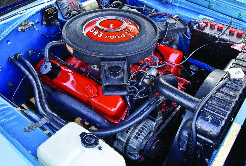

Pictured is the engine compartment from a '70 Road Runner that was in a Hemmings article. It's the correct crinkle-finish air cleaner, but the decal placement is pretty much where they were from '71 on back to '65, and on the '65-'66 383 2bbl air cleaners. That air cleaner is the later style mentioned. It might be a tad rearward for what the single snorkel air cleaner placement was, due to the extra rh snorkle's placement. No matter if it's a B-body or C-body, they were in the same place.

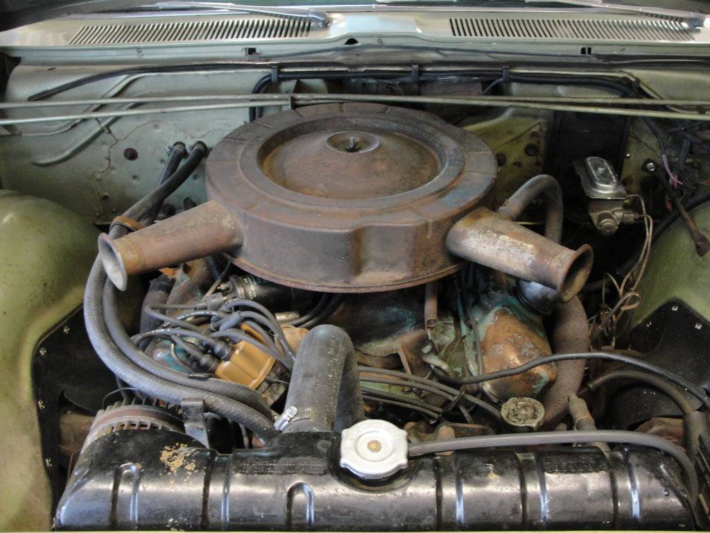

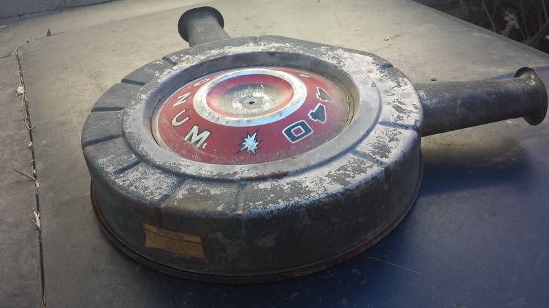

If you look real close at your air cleaner you may see were it had been they usually leave glue residue on the metal when they come off.

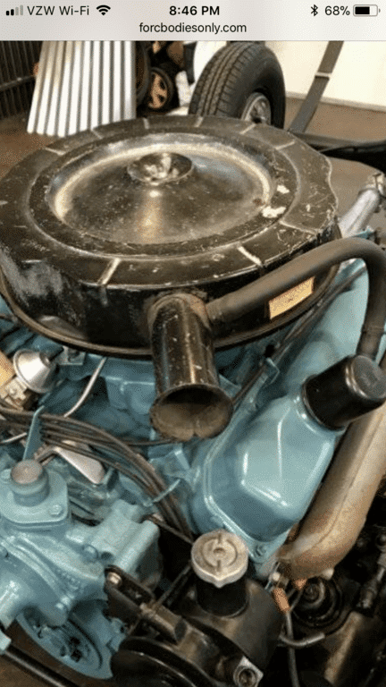

Here’s a 68 383 2bbl for reference. Original

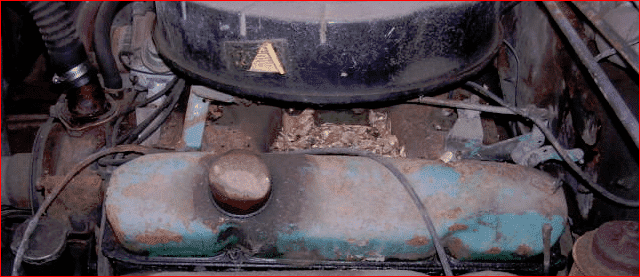

Here's another 68, yellow sticker on driver side. The previous owner of this, (from 72 to 2012), said there was another one on the air cleaner that fell off but didn't elaborate on what it was. Looks like there may have been something on the left snorkel.

Thanks guys, for all your helpful replies. Yes it was the yellow one with red letters in all the pictures. Looks like it was one side or the other of the air cleaner. Never knew there were so many colors of valve covers! Sure glad I powder coated my air cleaner after seeing these photos! (Except for the pristine Road Runner engine.)
