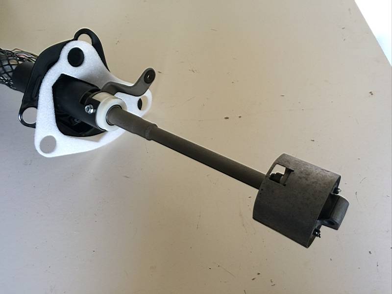

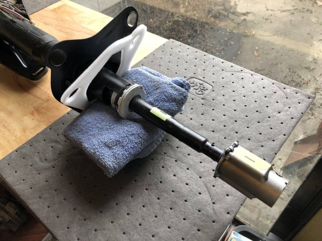

I can’t speak for older years, but my ‘70 300 convertible has a straight shaft column, while my ‘70 coupe has a rag joint. I thought it had to do with the fact that my coupe has the torsion quiet isolated stub frame, and my convertible has the solid mount frame.
Convertible column:
But, I was looking at a friends Canadian made ‘70 convertible and it has the rag joint and the solid mount frame, so that theory went out the window, or perhaps it’s a Canadian thing?

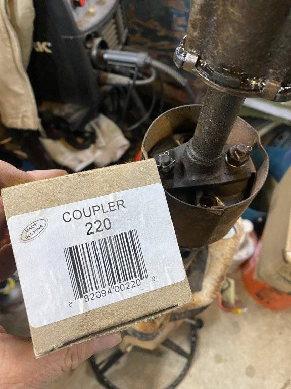

The rag joint coupler is being reproduced and is available from Rock Auto. I had to replace the one in my ‘70 coupe, it is a perfect fit. Here is a pic of what I used:

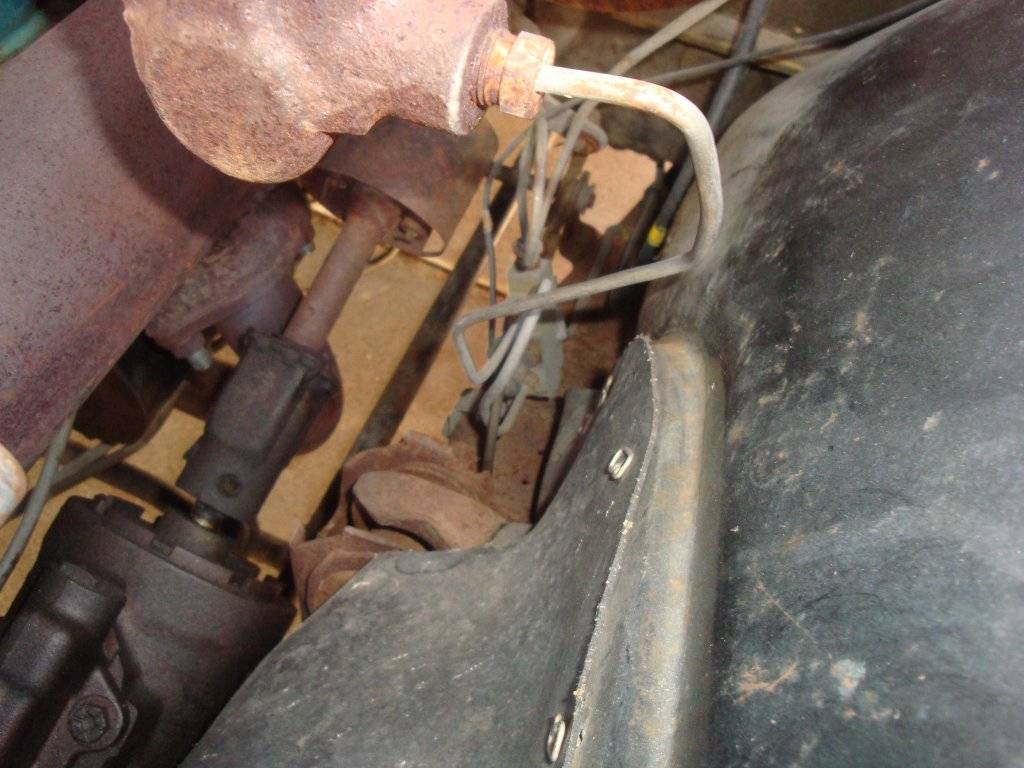

Polara 1. 1969 4-door sedan, 318, power steering, column shift: Standard coupler only.
Polara 2. 1964 4-door sedan, hp440 manual steering, column shift: Rag Joint, no standard coupler.
Polara 3. 1969 Convertible, hp440 power steering, tilt wheel, floor shift: Standard coupler only.
I have seen cars with both the standard coupler and a rag joint.
Polara 1
Polara 2
Polara 3

They tend to go bad when people remove the heat shield to change the spark plug, and don't put it back on. They're a pain... but serve a purpose in protecting the coupler...
With the heat shield they'll last 50 years... as did all of mine.
Lares 220 from Rock Auto.
