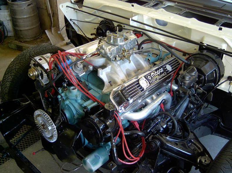

It took 9 hours with a port-a power and breaking a set of jaws to get this 440 in, when it should have taken an hour. The shift linkage was not an issue, however the fact that the C-body A-arms are much larger and the torsion bars being closer together are huge issues that make them incompatable. With much frustration, work and swearing they did fit, but they will still rub the passenger side torsion bar under torque. I will be putting the stroker back in with $850 polished TTIs.

Ah, that's exactly the frustration I'm trying to avoid. Beautiful by the way! I hear TTI is the best way to go.
