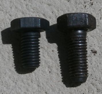

About a year ago when I bought (the wrong) U-joints for my '67 Monaco (from rock auto), I also bought GMB 260-0266 strap kit (the 2 half-circle straps with bolts for connecting the rear U-joint to the differential). I'm just now looking at this, and I see the bolts that come with the kit are significantly shorter than the factory originals. So I'm not going to use this kit. Maybe I'll use the lock washers and the actual straps - given the different cap sizes that are possible here I don't know if these straps are made exactly for a specific cap size or not.

FWIW, concerning thread length or really the better term is thread engagement length. The rule of thumb for steel fasteners is 1 to 1 1/2 length. So with a 1/4" bolt, you want a minimum of 1/4" and if you multiply that by 1.5 you end up with 3/8" thread engagement. For other materials, it may be better to add more engagement length, but that's another story. Anything longer than that does nothing to add strength as the bolt will break before the threads pull out.
So, the short bolt is probably OK based on my eyeballing the picture. That said, I would also choose the longer bolt and no matter what, use a lock washer like the factory did.
BTW, I broke a set of these bolts on my drag car years ago. Broke it on the first dry hop after the burnout. The solution was to drill and tap the yoke for a larger Grade 8 allen head bolt.

ALWAYS check the bolt length against the "hole depth", so that the bottom is not reached before the item is secured as it needs to be. Resulting in a false torque reading in the process when the bolt bottoms-out rather than getting tighter.
