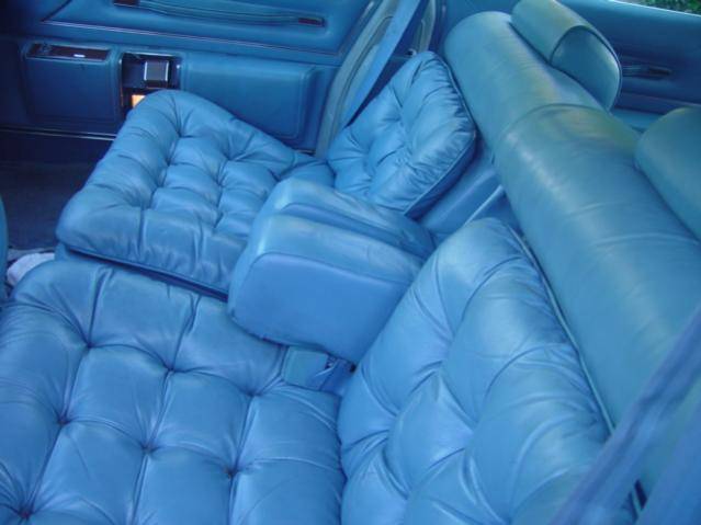

I've seen a for sale ad on the site where someone was selling a Fusie with Formal seats in it. It appeared that the Formal seats physically fit in a Fusie. I don't know if it's a direct bolt in or if any mod's and additional holes drilled are required to bolt them in. If you do it...I would find a set that has power seats on both front seats. BTW, the fronts seats are 50/50 split bench. So that means that the front seats are actually two separate seats. They are heavy as hell too.

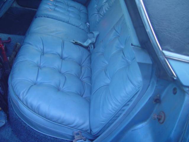

As mentioned they will fit, but not well. Especially the rear seats which are more narrow. There will be large gaps on either side of the rear seats, so it won't look right.
