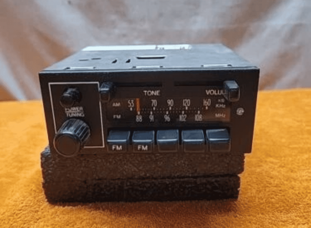

I had a 1976 Toyota Corolla once and the model with the knobs, Even though looked almost the same, was like, I don't know, an eighth of an inch wider than the model with the knobs on the left, and you wouldn't know unless you physically tried to put it in there. Everything was very small in that car

Here's the two Toyota radios I was talking about , they are NOT interchangeable , BUT they had the same hookups if I remember correctly. , and they have like the same size hole or something. My memory is fuzzy but I remember they looked like the would fit interchangeably but they did not hah the radio dial on the lower one were like 1/8 an inch too wide and it was super frustrating. The lower radio even comes with a black faceplate sometimes to make it look even more like it will fit. Haha
