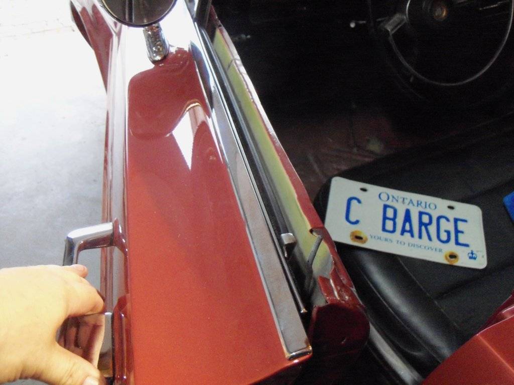

I used 1/8 rivits in place of the factory staples. Touched up the rivet head with a black Sharpie I had on hand. Invisible and the rivet head sinks plenty deep into the whisker so glass will never hit it.
