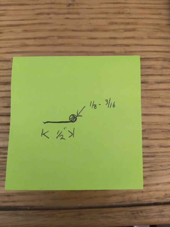

1970 300 converable windshield has this gasket between the glass and the frame, see pic for what it looks like from the end. It goes on frame first then the sealer then the glass. Its like you see the roll part next to the glass and metal from the inside instead of glue??? Anyone know where to get new replacement???

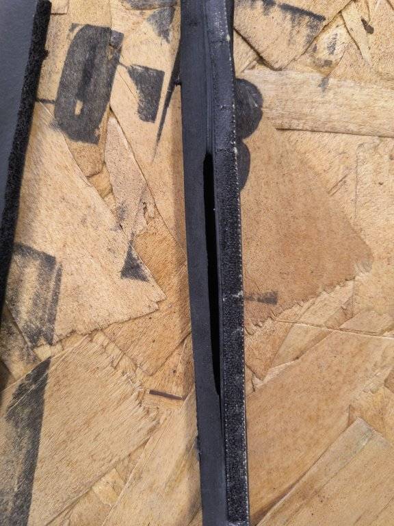

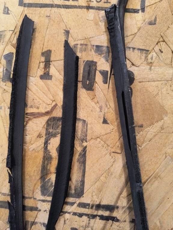

Im having a pro put it in, just looking for that filler piece. I will take a better picture.
