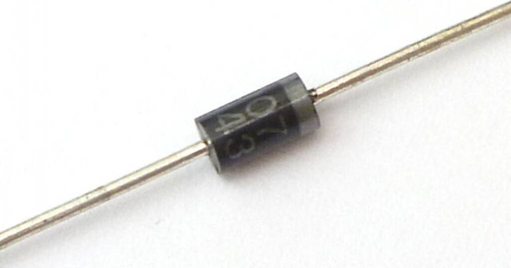

in behind the gauge cluster there is a harness connector that according to the FSM is for a “ lamp on reminder buzzer diode”.
Can anyone post up a photo of what one of these looks like, and tell me where I can get one?
Mine was missing too.
I made one using a simple diode and a connector from a scrap harness. I didn't take a picture, but here's what one looks like.
