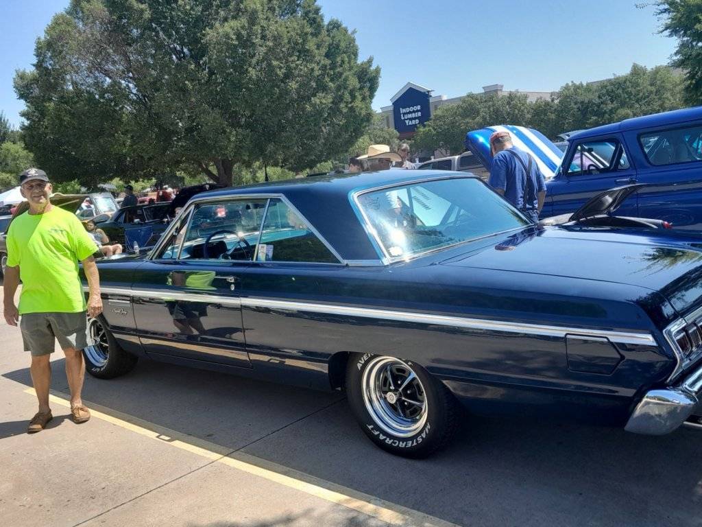

Thought I'd post a pic of the ol' steed

At cold start, try cranking the engine 10-20 sec. without pumping the accelerator, to give the bowl a chance to fill, then attempt to start with a couple pumps. Nice Fury BTW.
