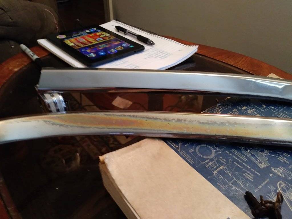

I figured I should work on cleaning up the stainless trim since I have the back window out and will be painting the roof soon...

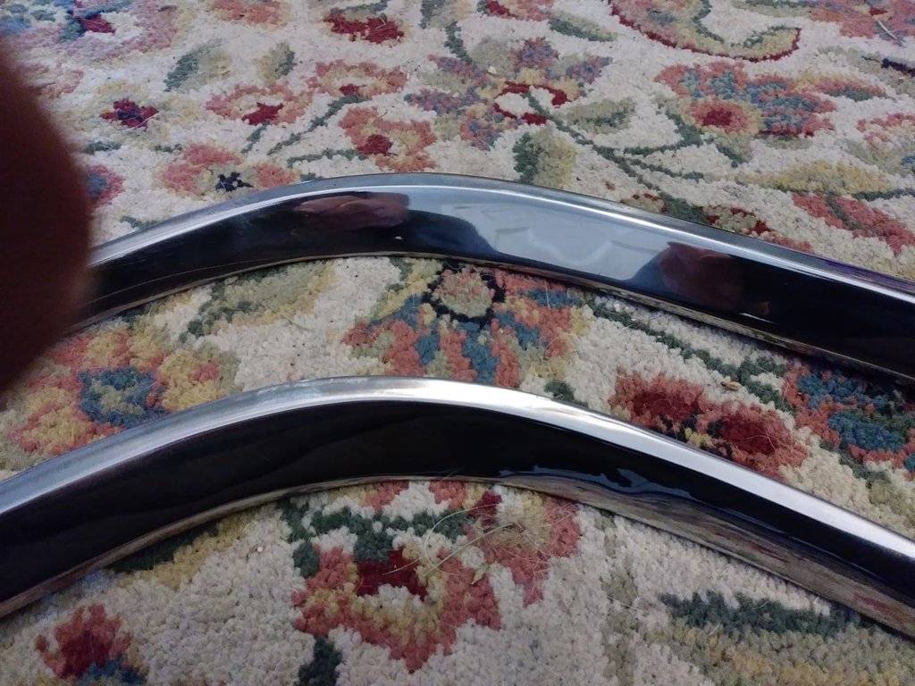

Night and day!! Great work!!
Polishing stainless is one of my favorite things .
I start with wet sanding with 1000,then 1500 and 2000.
Then I use black rouge on my buffer then green.
hand polish with Mother's is icing on the cake.

This was just using some red I had laying around and the wrong wheel. I have a ton of black and green at work and the proper wheels. I polish some SS parts at work and they come out as a mirror....I want that.
