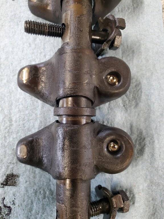

Thanks for the reply. The engine came out of a Imperial and with 80K miles I though maybe a rebuild of the oem pump would suffice but I'll check for grooves. On the rockers it seemed to me like the lower part was pretty thin and there was some side movement.

If you take the rockers off the shaft the hole should be circular, oval is no good. I've seen these do that, very random, side to side is okay.

The rockers are very sloppy on the shaft when off the engine. At 80K they should be good.
Okay, I took a picture of the under side of the rockers for you to see, looks weird to me, removed one from the shaft and there round ...I have a video also. The cylinder walls look great, no ridge.
Looks normal. When they are installed and the tension is pushing up on both ends they get tight.
