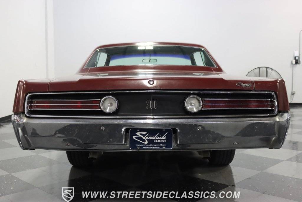

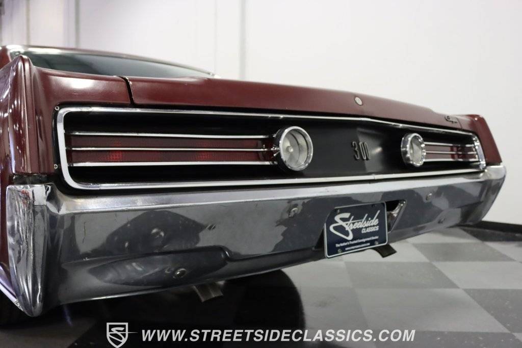

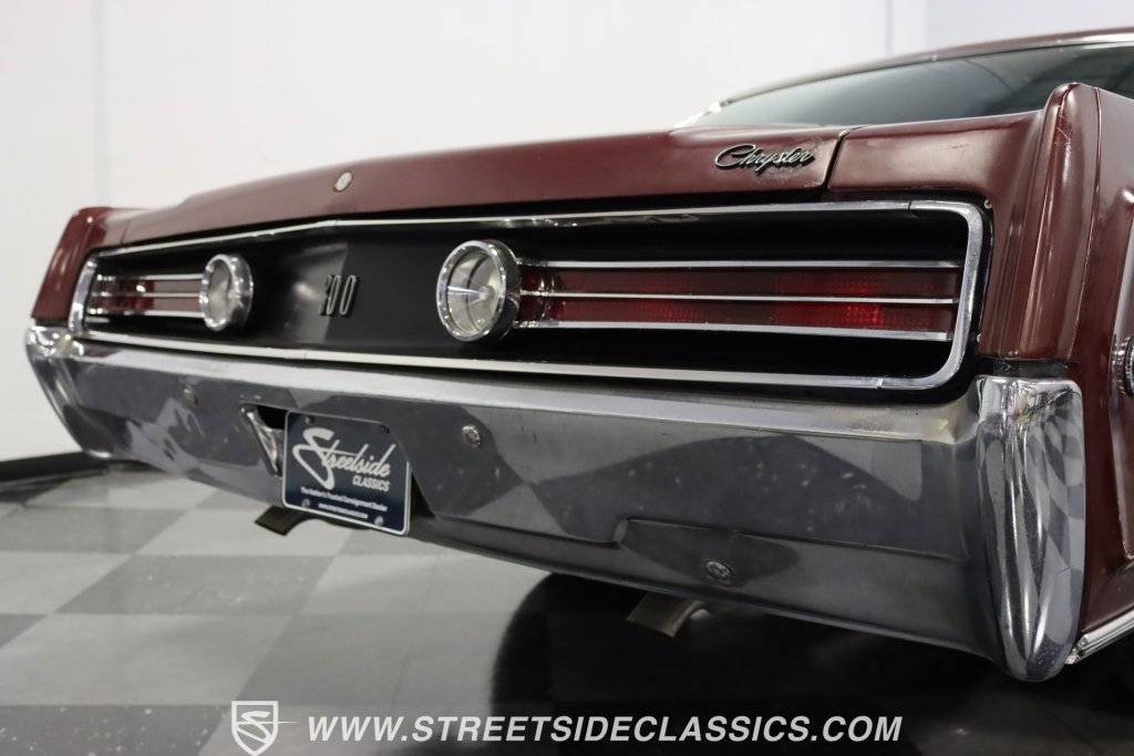

Grace is still wearing her factory tailpipes.
Note they do not extend past the bumper unlike the TTI system.

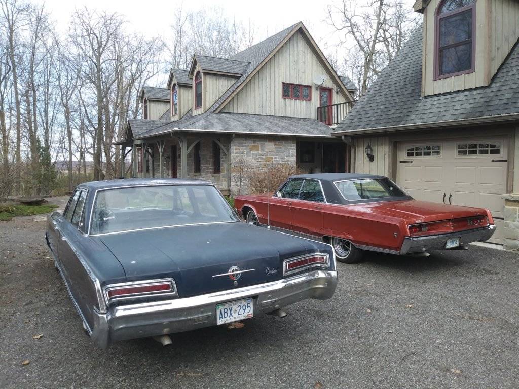

I have the tips both sticking out past the bumper, and stopping just before the bumper on my '66 Polaras. They fit fine under the bumper, as the upsweep is far enough from anything that might interfere.
I had turn downs on mine, my exhaust guy did all the bends. 2-1/2". Kept them tucked under nicely I thought and not to far out past bumper. He researched and got correct angle per chrysler dual exh specs for 68.
