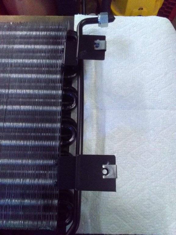

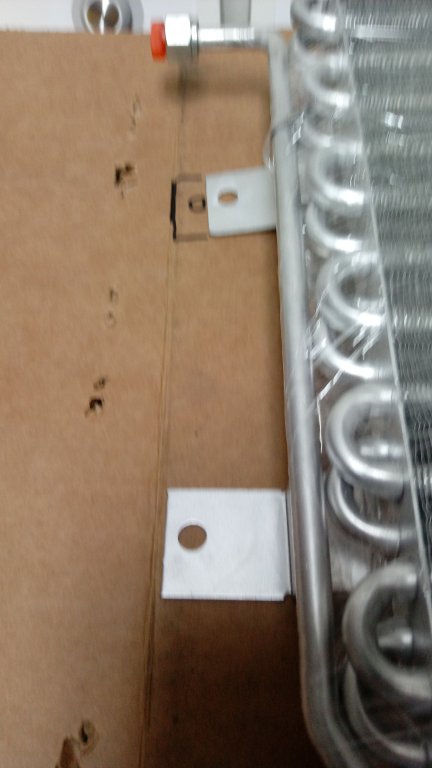

old thread and no idea if you'll see this but just got a 65-68 26" C-body consenser from you and the upper passenger side bracket is incorrect...upper and lower on that side should be the same length and it appears that the shorter drivers side upper bracket was used on the passenger side...I don't know if you're building all of them this way or if I just got unlucky and your guy grabbed the wrong bracket
Let us know how this turns out. They should replace it with the correct product.

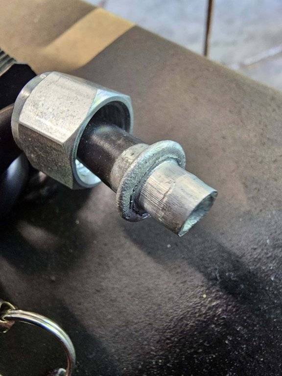

another thing i hadn't noticed when i first posted this was that whatever tooling was used to put the flare on the tube end really scored the tubing and built up flash...I was concerned that the o-ring might not be able to seal it...in addition it was .300 long and
it bottomed out into the other fitting...the original was .200
Latest update...sent the previous pics to them (via eBay)and explained the problem...they sent out another condenser...on the new one you could see they cut off the original fitting and welded on another one ...not the prettiest job i've seen but functional
but the upper bracket was still wrong...fortunately I still hadn't sent the original one back (cause I had a feeling this might happen) so I was able to steal the lower bracket off that one...so I guess they're all made like this and the original one I received wasn't just a one time screwup
