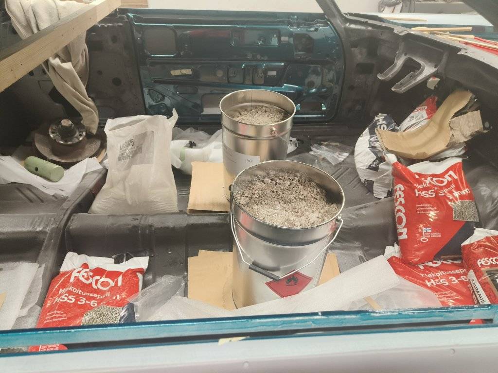

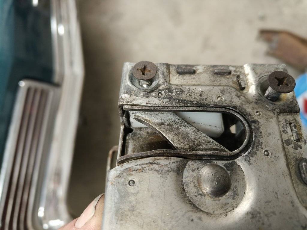

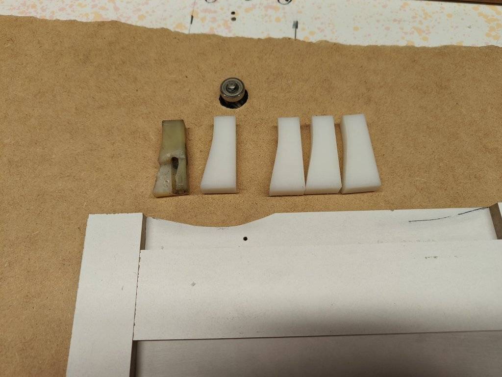

Small update , somehow I destroyed this piece of plastic what's inside the door lock but luckily I had white polyethylene and that's good material for new one. Notice preload in engine compartment and inside the car, idea is simulate the weight of mechanical and other parts, hope this keep caps between parts equal when it's time for final assembly. Next is time for filler body work, basicly Evercoat products, I measure harder with table scale, easy way to have a correct amount hardener.

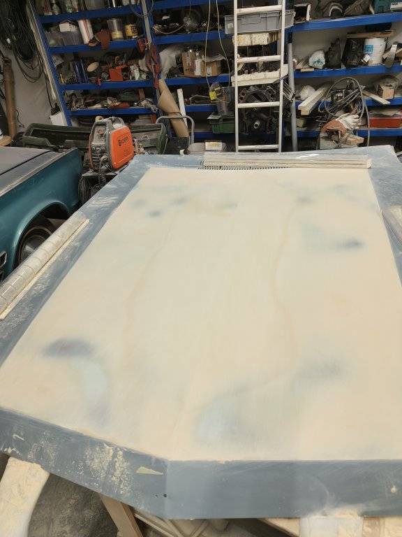

Hood centre section ready, much easier to do before installation. Not bad and there's no thick layers, there is two coats of epoxy primer, first red and then gray so when sanding and if you see red primer just stop sanding.

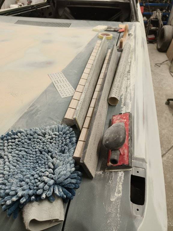

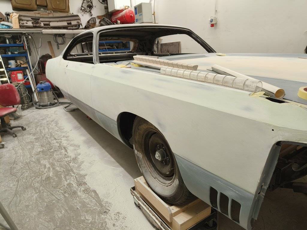

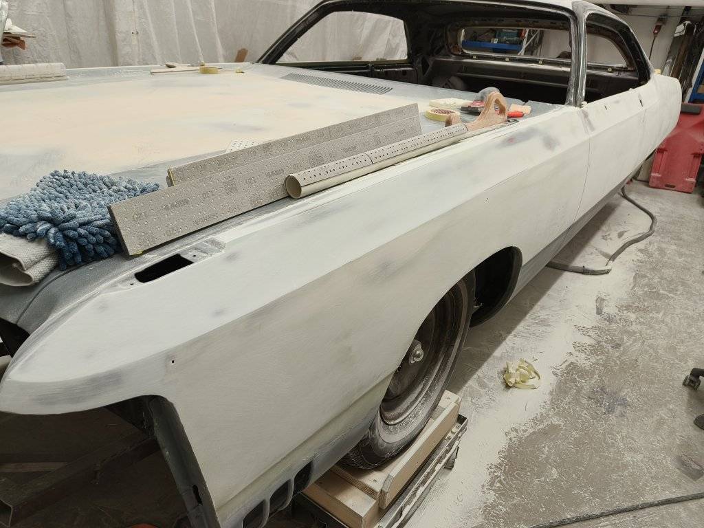

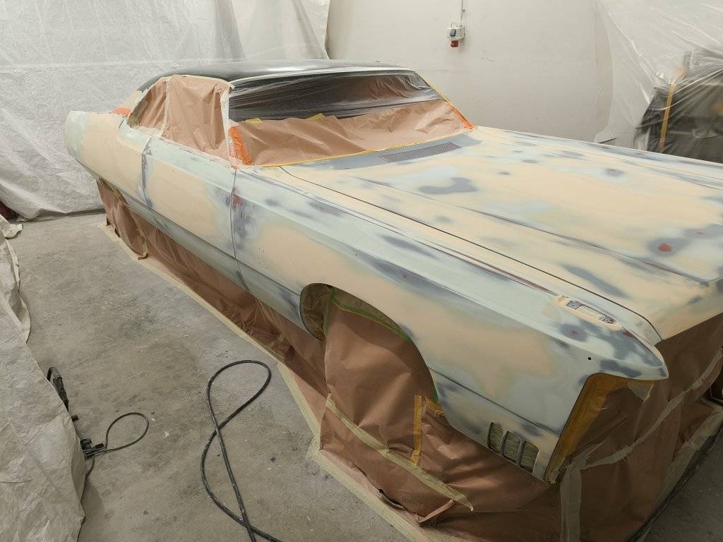

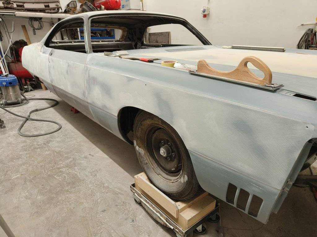

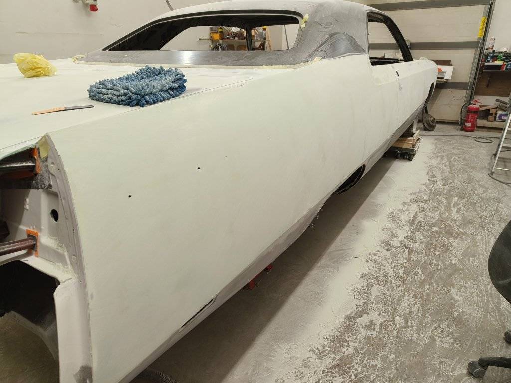

Getting there, panel by panel. I want to make surface as smooth as possible before next step, very thin layer over all surfaces, sanding and then Evercoat Slick Sand and then blocking.. and then sanding primer...so sanding.. and then.. sanding.. and.. after that.. some sanding...
quality time with my shelf and sanding tools,(home made..of course)...,:)
.. about products, and this is not a advertisment , I used Evercoat Rage Ultra and Ultra Extra ratio 50 to 50 for large areas ( we can say these are large areas..) because of extented spreading time and sanding for Finnish made Mirka Iridium sanding paper, excellent product's!
...sanding..to be continued..

How long are those blocks and did you make them by hand?
800 millimetres/31.5 inches, an other one is more stiff and just a little flexible and the other one is more flexible. I think that's long enough .Time to time in my day job I had to do some special sanding blocks to some specific job so there's nothing new...:)

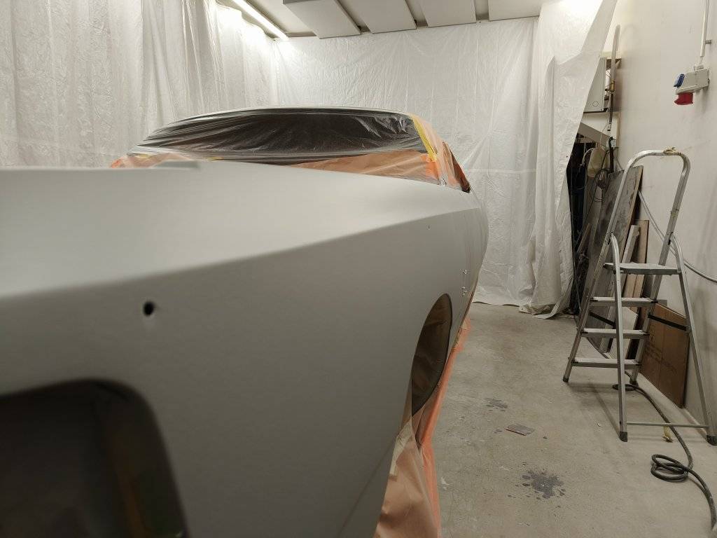

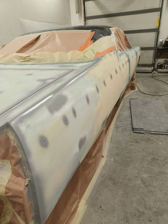

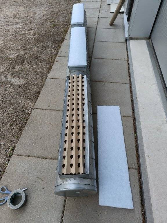

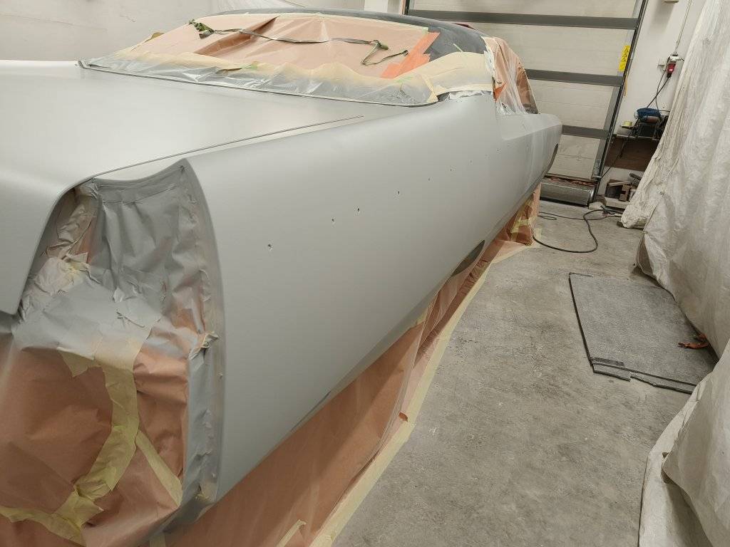

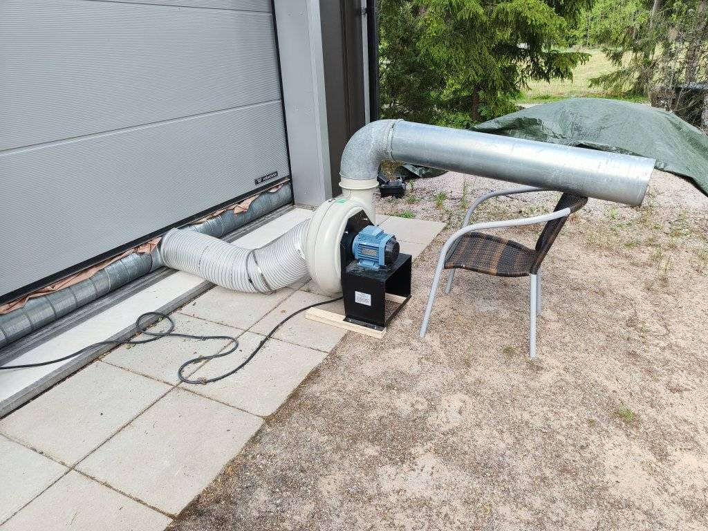

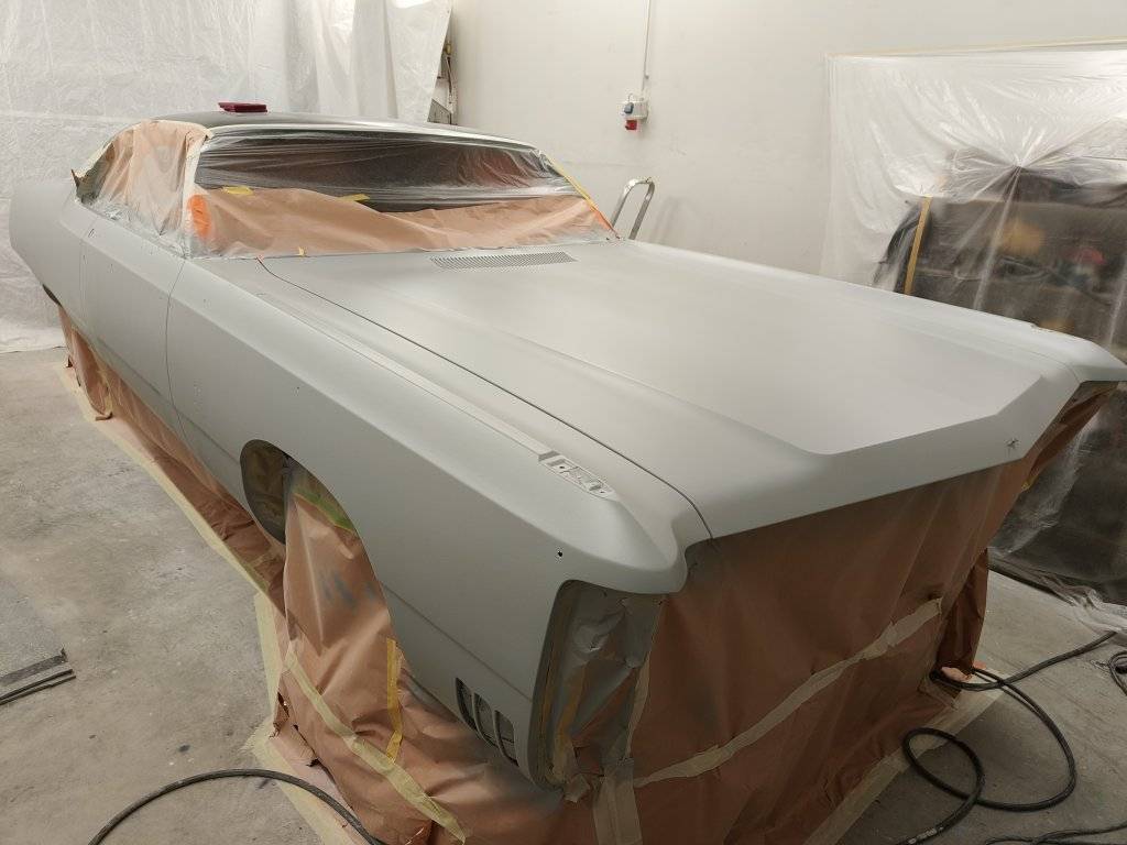

Finally..!.. some progress, Slick Sand sprayed, two coats, looking good. Before spraying some exhaust fan project done, garage air intake ventilation in use (exhaust not in use) worked fine. Guess what next...oh yes.. sanding Exhaust fan is explosion safe,Of course. Every place where is bare metal , there is epoxy sprayed before Slick sand.
Regards,
Mika
