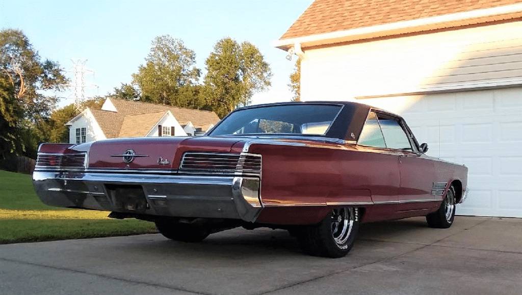

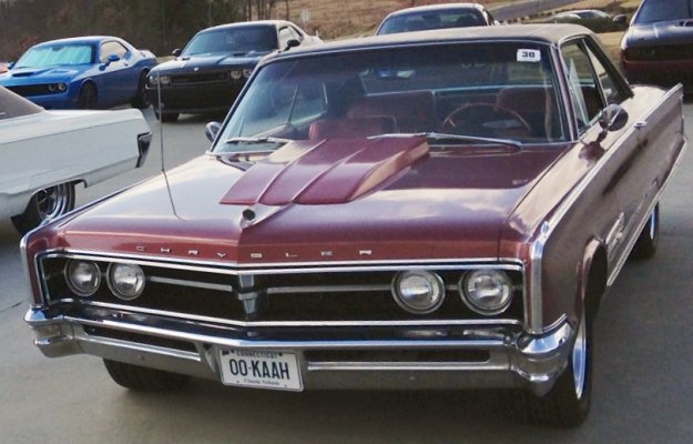

1966 300 - The Flyin' Whale
493 cu. in engine, HD 727 w/Gear Vendor overdrive, 3.54 Dana 60 Sure Grip, 4-wheel disc brakes
General Information

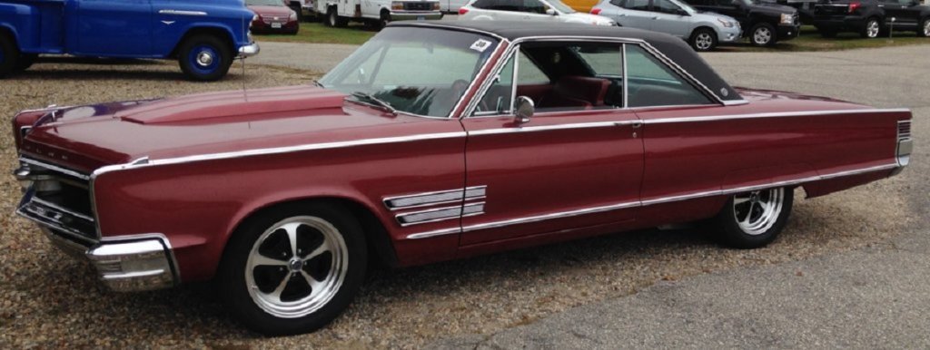

1966 300

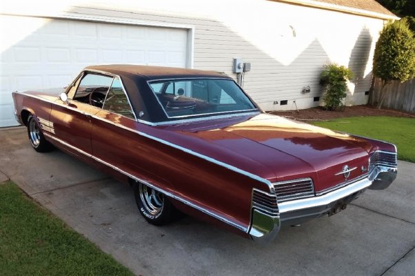

Originally a 383-4V "TNT" car, it was bought new by its first owner in fall 1965 from Fair Chrysler-Plymouth in Sacramento, CA.
After 34 years with its first owner, it was sold in 1999. The second owner built it into its current mechanical form – nicknamed The Flyin' Whale -- in 2005.
There was a feature article on this car in Mopar Action magazine in June 2006.
The modifications were done at ~120K miles. It has ~126K miles now. Vehicle still has its (original owner touched up the passenger quarter before 1999) all its original Spanish Red metallic finish, vinyl roof, and interior.
It was sold to a third owner in late 2006, then a fourth owner in 2007 where it sat (undriven, out of public view in storage) for about 10 years. It was purchased at auction and revitalized by its fifth owner in 2017.
Mechanically, it remains substantially as built by its second owner. The second (builder), fifth, and current (since summer 2020) owners are FCBO members.

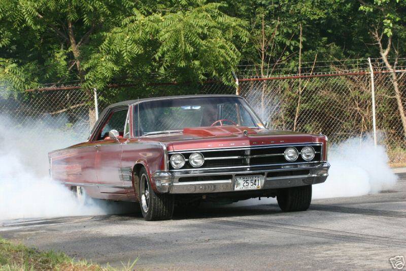

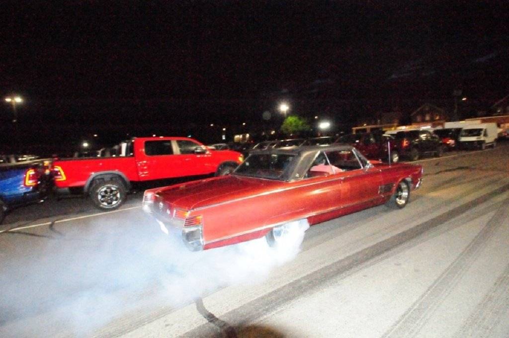

Vehicle performance summary: Track-measured when built in 2005 (vehicle weight ~4,000 lbs.), its best 1/4 mile time was 12.2 seconds at 114 mph, with a 60 ft. time of 1.94 seconds (using street tires).
Its (estimated by calculation, @6,500 RPM, sixth gear) top speed was: 180 mph.
Engine performance summary: Dyno-measured at build time 700 HP (at crank) and 550 HP (at rear wheels) at 5,800 rpm, 500 ft. lbs. torque at 4,800 rpm, 11.3:1 compression ratio, using 93-octane pump gas. Redline is 7,500 rpm.

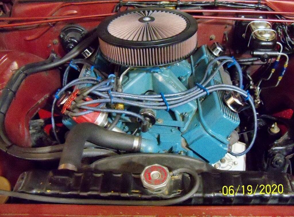

Engine
493 cubic inch (440 bored .030 over, stroked) built from a 1974 Imperial engine block
. Block partially filled, flashing removed, crank clearancing, and machined valve reliefs
. Billet steel main caps, ARP studs, polished steel crank (4.15" stroke), .200 over “H-beam” rods
. Forged, polished tops, dish pistons, full floating, tapered wrist pins
. Windage tray, 7 quart, baffled oil pan
. Edelbrock RPM cylinder heads, ported/polished, 2.19" intake valves, polished combustion chambers
. Solid roller cam, 1.6 ratio roller rockers, roller lifters
. Holley HP 950 cfm carburetor, 150 gph fuel pump, port-matched Edelbrock Victor intake
. Hooker Super Competition headers

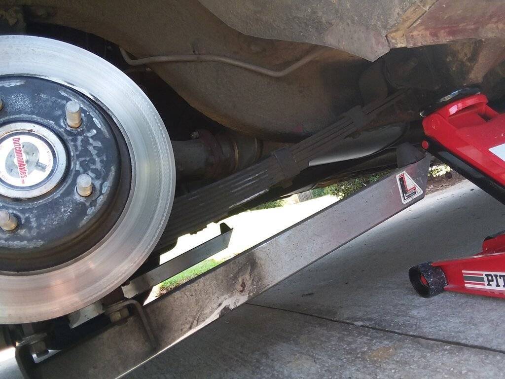

. Front disc brakes (1973 Chrysler MY), 11-3/4" rotors, with stock OE calipers and braided steel lines
. Custom leaf springs (9 leaves), front leaf mount moved inboard 7/8" for wider rear tires
. Rear disk brakes (11” rotors from Lincoln, OE calipers from Cadillac), with operable emergency brake

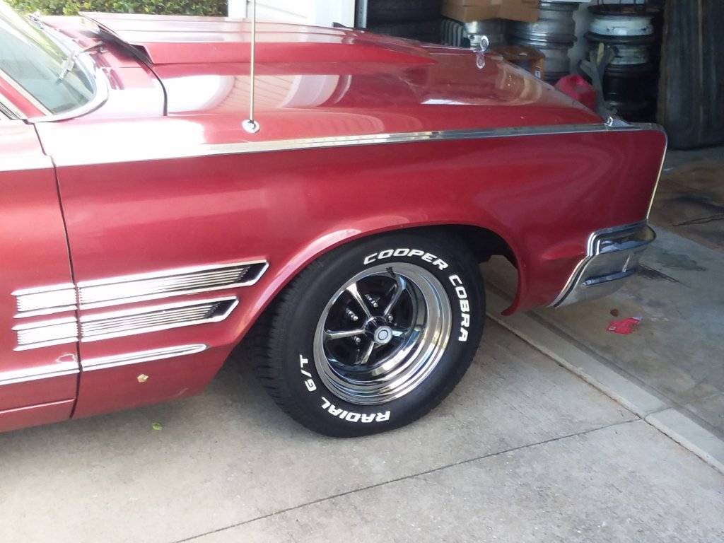

Tires

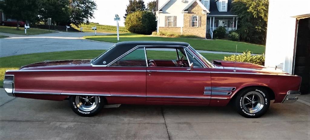

15x8, 4.0 inch backspacing, “Magnum” wheels in front with 245/60 tires
. 15x10, 5.0 inch backspacing, ”Magnum” wheels in back with 275/60 tires
. 17x9 wheels, w/ "W" rated radial tires for high-speed usage

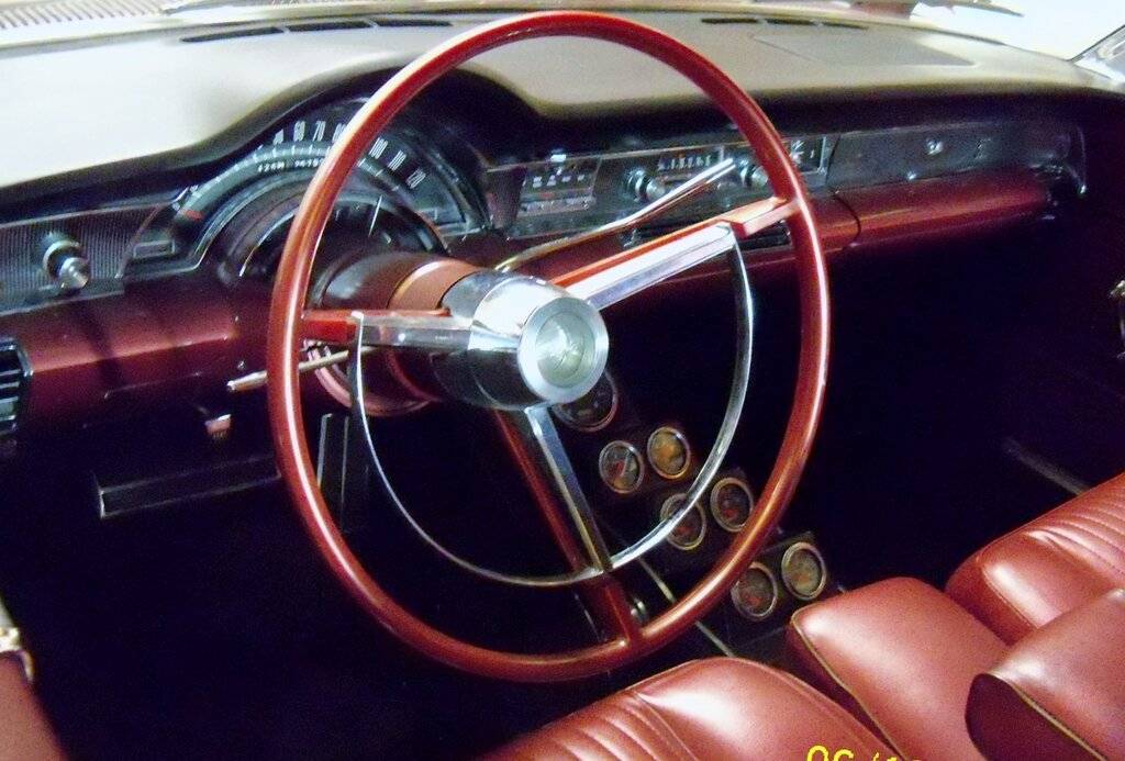

. Custom-made gauge cluster with tach, oil & fuel pressure, water & trans oil temperature
