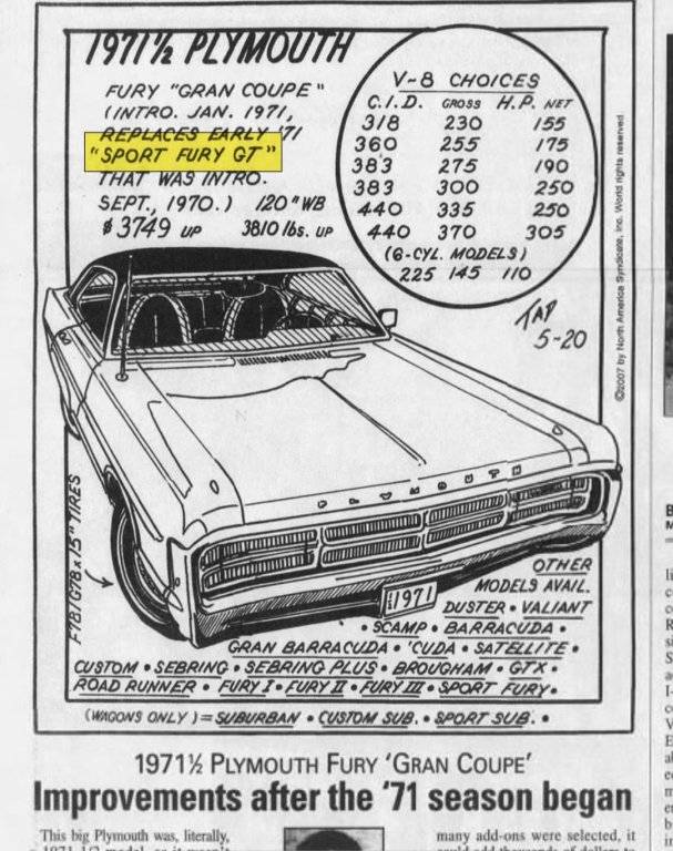

I'm suspecting "Fury Custom" was a Spring Special model? Might a data plate picture also be taken? Which would have the production schedule date and first part of the VIN.

PE21G1F107432 sports an early VIN sequence, so it is likely an August 1970 build (indeed, the scheduled build date was August. 31, 1970). I doubt that it'd be a special that early on in the model year, but that's only a guess: @67valiant 100 (who tracks F-plant cars), @69CoronetRT (who has a lot of info on fusie builds), and / or @70 Sport Suburban (a Fury aficionado is ever there was one) may be able to chime in.
There's some wonky coding in 70 and 71. The A94 indicates a special 'package' or 'body style' or 'administrative modification' of some sort. I do not have a '71 window sticker that lists details so I don't know for sure.
