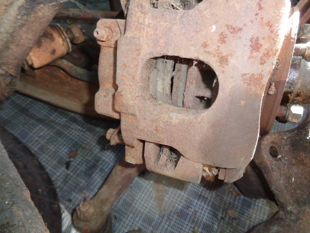

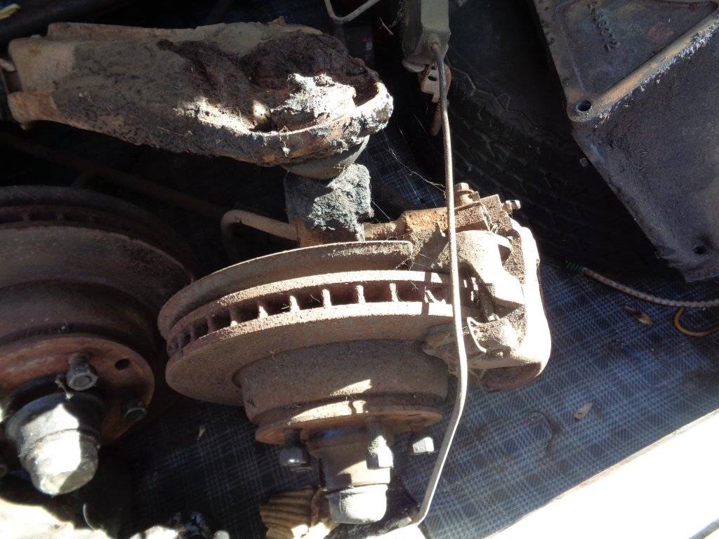

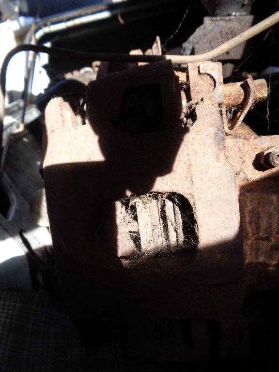

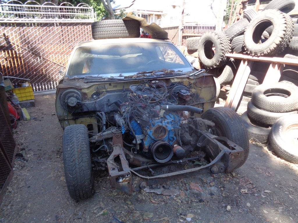

1974 spindles on a ‘65. Can this be done?

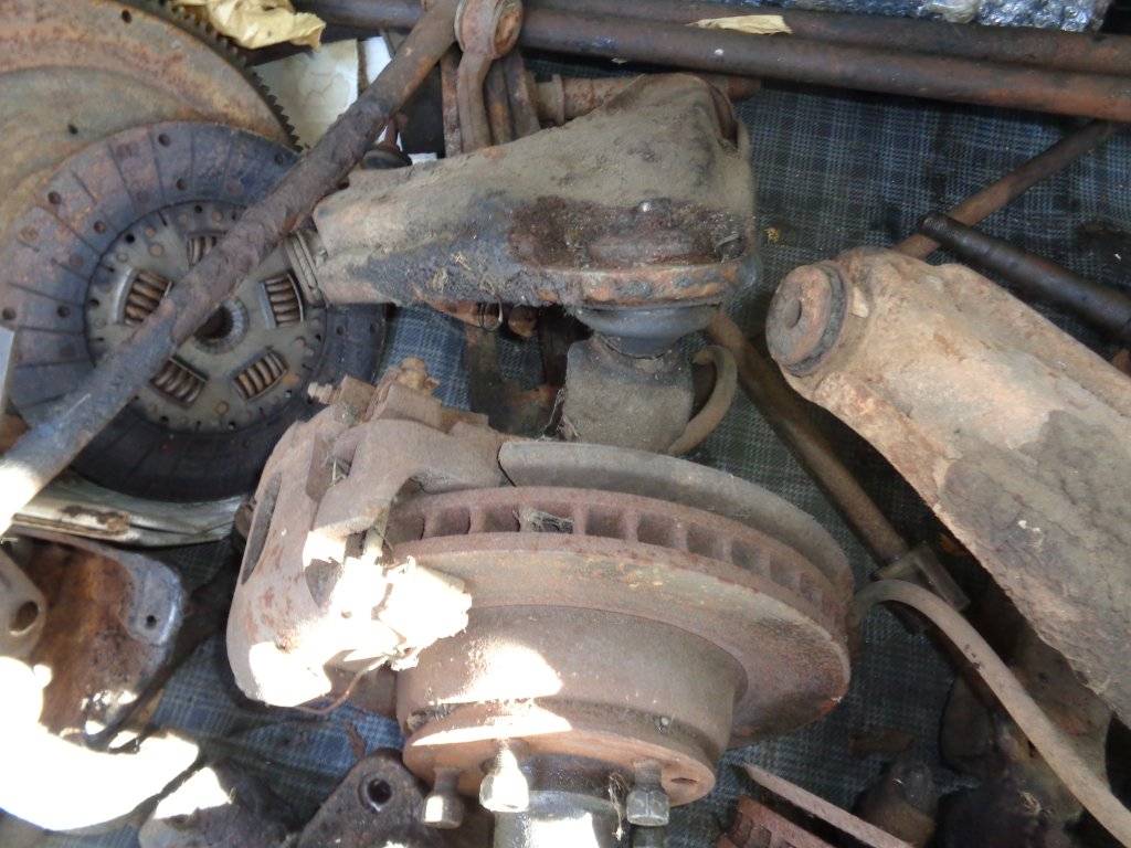

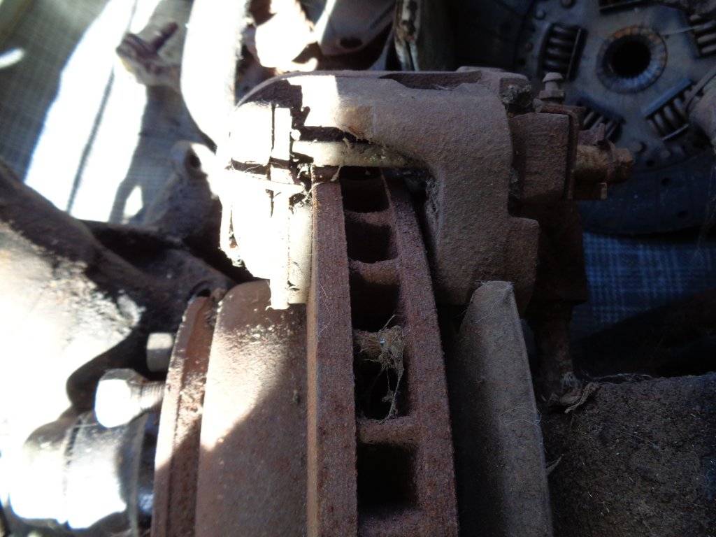

i'm thinking that 64 c bodies are a different animal spindle was , the steering box is mounted aft or to the rear of the steering assembly . 65 up 73 is just what the doctor ordered . so it's the widely costly 65-69 budd setup , are 70-72 which bolts right up with a single piston calib or 73 which has a larger rotor i believe . here's pics of a 70-72 style , this is for my 65 880 rag .

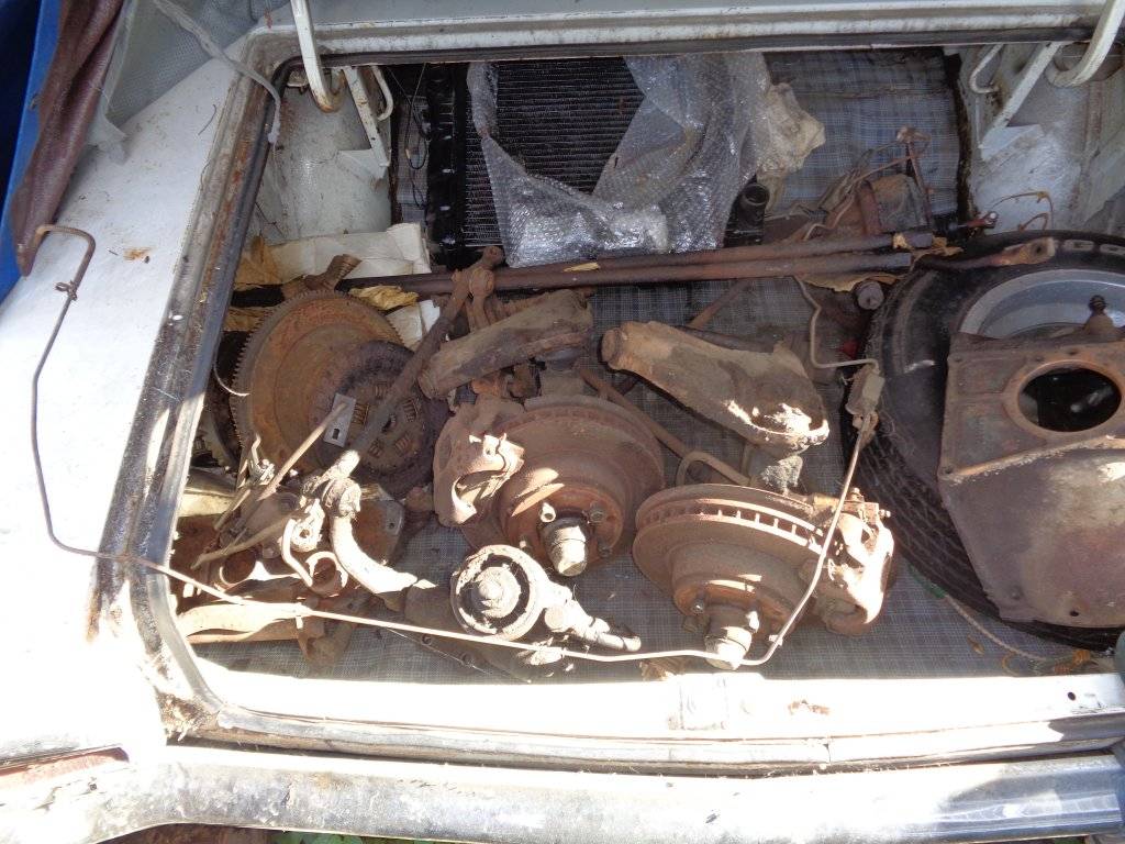

i pulled everything to do the swap , pb unit to brake lines and complete suspension assemblies , pulled the subframe but for use on my 65
