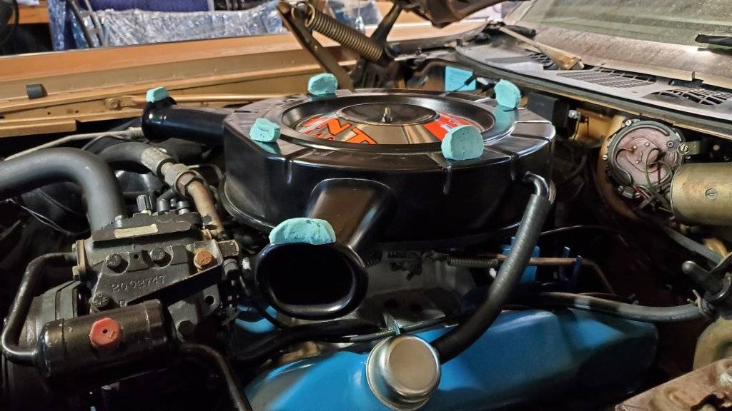

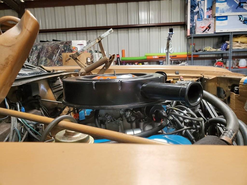

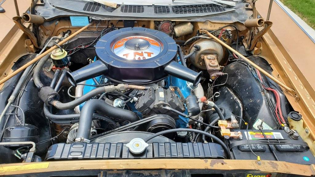

The build worked out well. I did use the Edelbrock Performer so that I can close the hood. It was close, used a Carter AVS 4640S with thin gaskets so the air cleaner just clears the hood. I was looking for more torque than horse power.
69 Chrysler 300, 440/505ci dyno results
Changed the rear end to a 3.23 Sure Grip, 2000 rpm stall converter, gets around 5-8 mpg depending how you drive it. Took it on a 1200 mile road trip.
