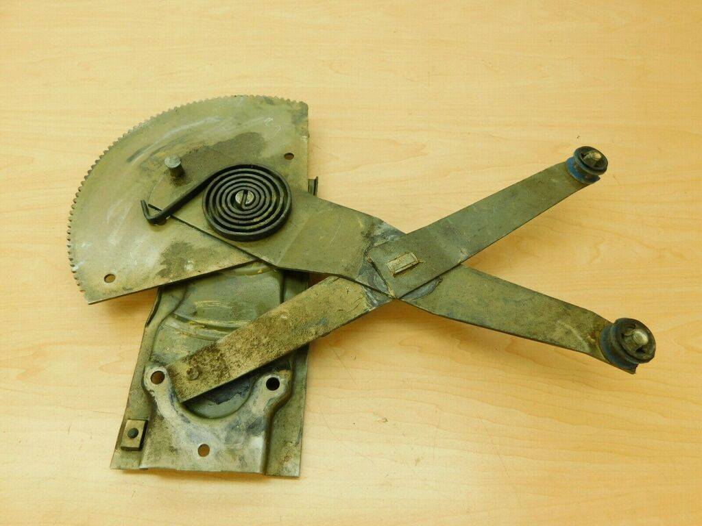

this is a regulator

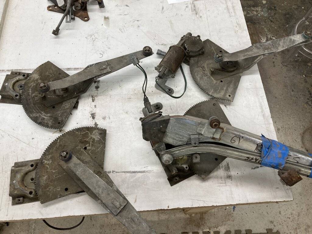

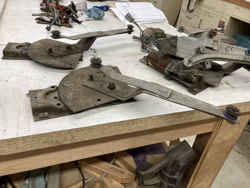

So these are 2 sets of rr regulators #’s 2802226(7). One set was known to be removed from a ‘67 Chrysler convertible while the other likely came from a ‘67 Imp 2 door. I’m not saying these are the same as ‘66 and take note of the offset that the arm takes off the elevator pivot and stay tuned for the next post as I have others that are earlier with less offset.

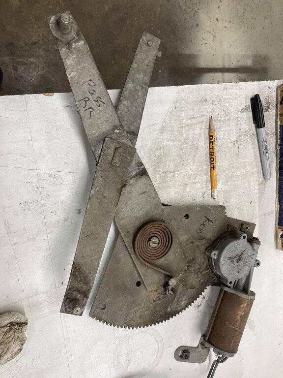

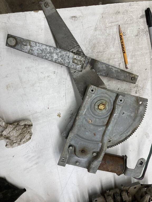

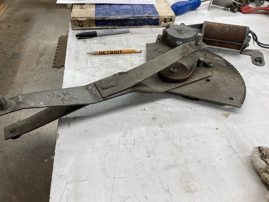

This is a passenger side rear part #2520568. I do not know what it was removed from but based on the part number I would think it’s ‘66 or earlier and definitely not Imperial. I have a few rear regs from 4 door ‘67’s and the rollers are a half inch further apart on them then the known 2 door units and this one below is the same as the 2 door regs but notice the lesser offset compared with the ones in the previous post.
I don’t yet have a parts book for ‘66 or ‘67 and none of these numbers are in the ‘68 parts book.
