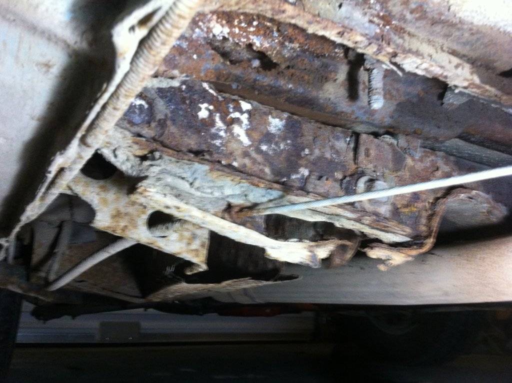

I got a '66 polara and as you can see my Stub is certified junk, looking for a replacement in the PNW area. Willing to go as far as oregon but that's about it, ideally here in Canada though. Mostly concerned about the metal as I expect to renew all the bushings anyway. I wan to put some serious power through this thing so discs would be nice as well but I can't be picky.

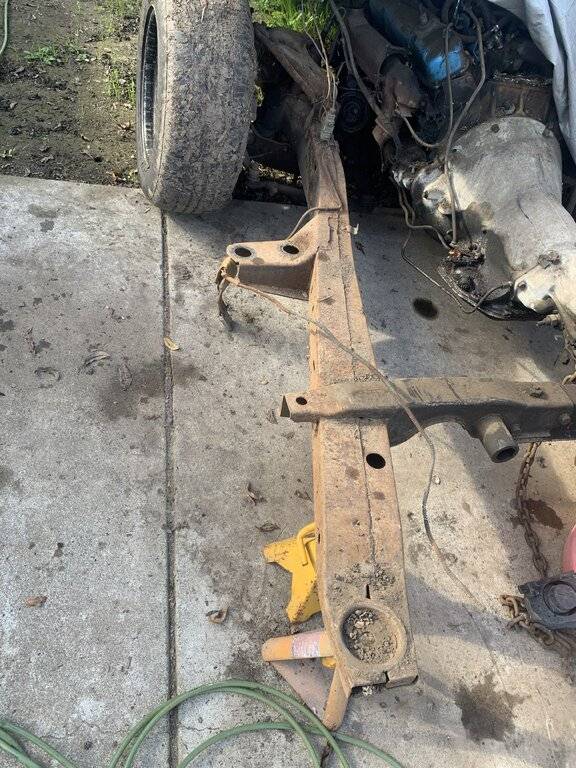

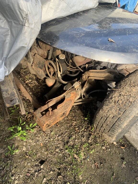

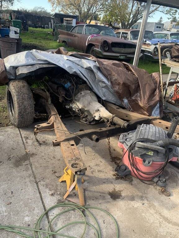

I have this out of a 1970 Chrysler 300.
It is rust and damage free.!!!!!
I’m pulling the the motor and disc brake parts. Torsion bars have been sold already.
Located in Northern California.
You can have it for FREE if you come pick it up
Sorry Sarge, that one won't work.
It's an isolated stub. He needs the solid mount.
If you had one out of a 1970 300 convertible, it would be correct for his car.
I'm sure someone could use it. The isolated stubs rot out even worse than the non-isolated ones do.
