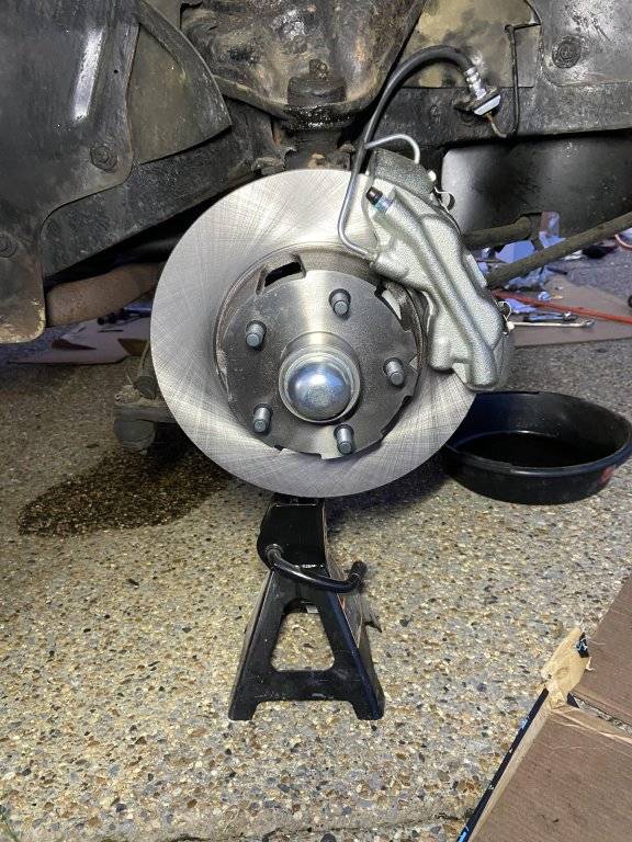

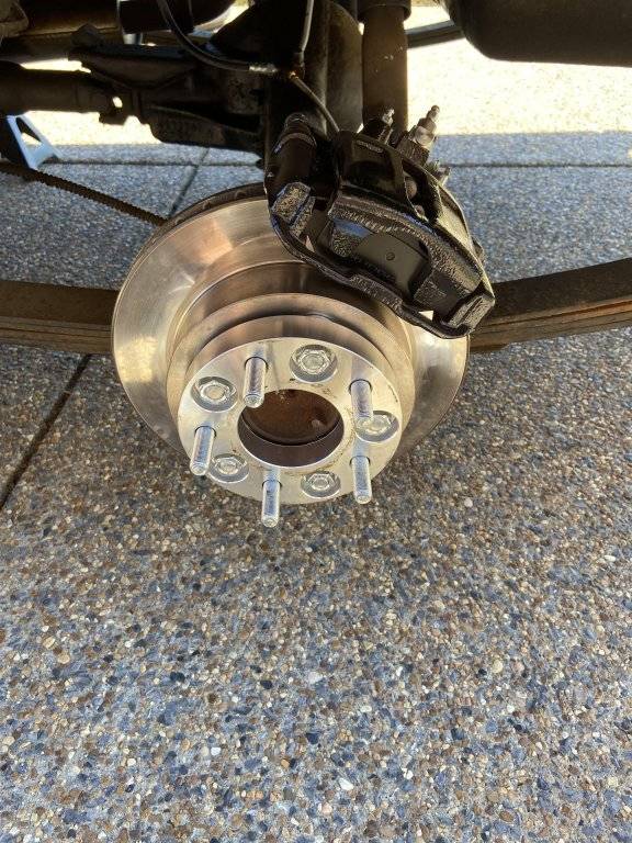

I put front and rear discs on my 66 Newport Convertible. Let me know if you want pics and the name of the company that makes the kit.
I'm definitely interested in pictures and how yours went and your opinions on it. I got a SSBC kit for the front and had a pretty terrible experience all around. Parts of the kit that didn't fit together, it was advertised as compatible with the factory booster, the rotors were warped out of the box, the pads seemed to be made of butter, and support was lacking.
Here are pictures of the front and rear disc setups. I had to put a spacers on the front and rear to clear the calipers because of drum style rims. I wanted to keep my original 14" rims and hubcaps and this setup worked perfectly! I had to adjust the side to side play on the 8 3/4" rear axles because I had the axles out putting new bearings on. Once I got them adjusted correctly, the brakes work great. The pads and calipers are 64-66 Ford Mustang units on the front. The kits for the front and rear came from Summit Racing and here are the details -

The best part is this kit allows you to use your existing spindles, no need to change to later disc style spindles. The only issue was with the brake pedal arm that attached to the booster. They sent three different lengths but none were correct. I had to modify the shortest one but I finally got it to work. Here is how it looks after the conversion with the spacers on. I also replaced all the emergency brake cables and they clicked into place perfectly on the calipers.

The best part is this kit allows you to use your existing spindles, no need to change to later disc style spindles. The only issue was with the brake pedal arm that attached to the booster. They sent three different lengths but none were correct. I had to modify the shortest one but I finally got it to work. Here is how it looks after the conversion with the spacers on. I also replaced all the emergency brake cables and they clicked into place perfectly on the calipers. View attachment 581481
That front kit is very similar to the one I got and includes the same calipers. I've heard lots of people say they had good luck with SSBC so maybe I'm the odd one out. I also had to modify the brake lever arm to get the correct length. I also went for the 14" wheel kit and regret it now. I switched to 15s a while later so I could actually buy decent affordable tires for it. At the time I was averaging 20k per year on the car so I didn't want to buy reproduction oem stuff.
Awesome. Didn't know there was a conversion kit for the rear drums. This is now on top of my shopping list for my 71 Newport!
