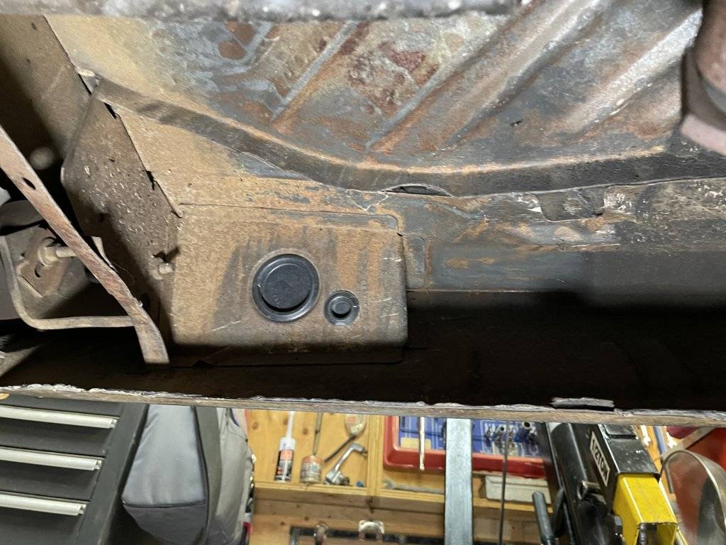

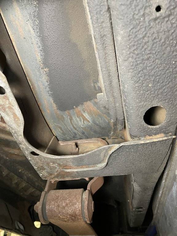

I’m trying to do my research on 72-73 Imperials before I even turn one wrench on disassembly. I want to compile information about these cars and build details similar to what is done for say Chargers, Superbirds, etc like a concourse restoration guide.
I’m requesting all kinds of pictures of body markings, and details from original, good condition cars.

As to "paint daubs" and "inspection markings", these might be somewhat consistent in some respects, BUT you also have to remember that it was human beings doing them AND one shift of human inspectors might do them just a bit differently than the next shift of human inspectors. Some of the more standardized stamps and related paints are available from the B/E-body high-restoration supply people.
Because of these variations between plant to plant and shift to shift (although I know the Imperials were all done in one plant), the absolute BEST way to do things is to photograph ALL of the markings on your car as you disassemble (or get ready to disassemble it) the vehicle. Carefully cleaning each item do discover the colors and method of application of each paint stripe/daub/stamp/splatter on YOUR car. Then you can also purchase some "approved" brushes from the above-mentioned MOPAR restoration supply vendors.

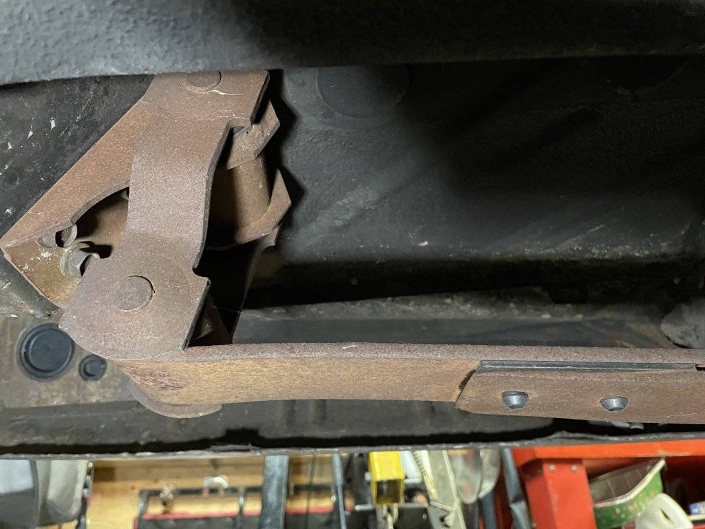

Back to the "inspection marks". These generally are on joints where the inspector verifies the bolt/nut torque with the paint stripe across what was just inspected. Like steering linkage joints, for example. Back in the 1990s, there was an article on these inspection marks and stamps in "Mopar Action" or similar. The Challenger restoration they were using for reference was way over-marked compared to any other stock Chrysler product myself or some others in our Mopar Club had ever seen. Reading such an article can be helpful so you know what you might be looking at on your car . . . or not looking at. End result was that their pictures of the Challenger's underbody looked very colorful, but it proved the point of what MIGHT have happened.

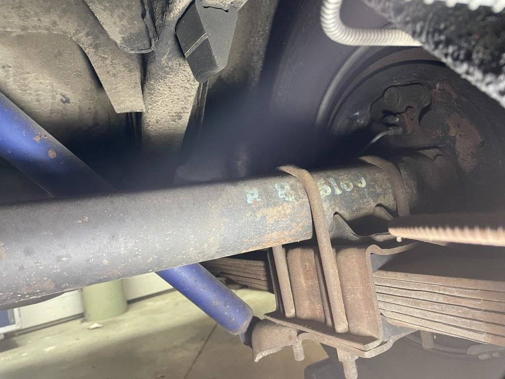

On the Superbird, there were three paint stripes on the lh axle tube. All the way around. Three different colors for ID on the production line. Plus the ratio and possible SureGrip tags on the rear axle center section bolt, on a particular bolt for each one.

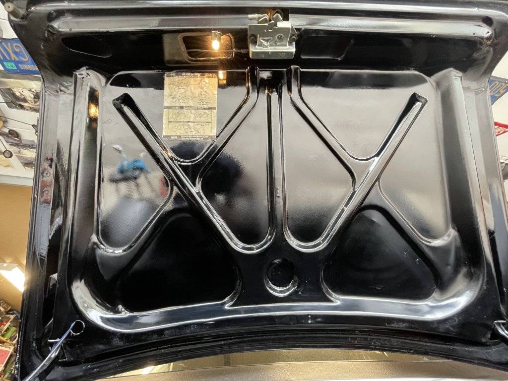

Of course, you'll want to document ALL decals under the hood, in the trunk, and in the door frame areas. In some cases, you might remove them with the use of a heat gun, provided they are in good enough shape.

In looking at how many paints and undercoats are applied on the assy line, you can look at the spray pattern to determine where the spray gun was located so you can approximate that same spray gun position and angle. PLUS where any related overspray might have ended up. Plus any "gaps" in the coverage. You'll have to restrain yourself from making it look "too pretty", too, all things considered.

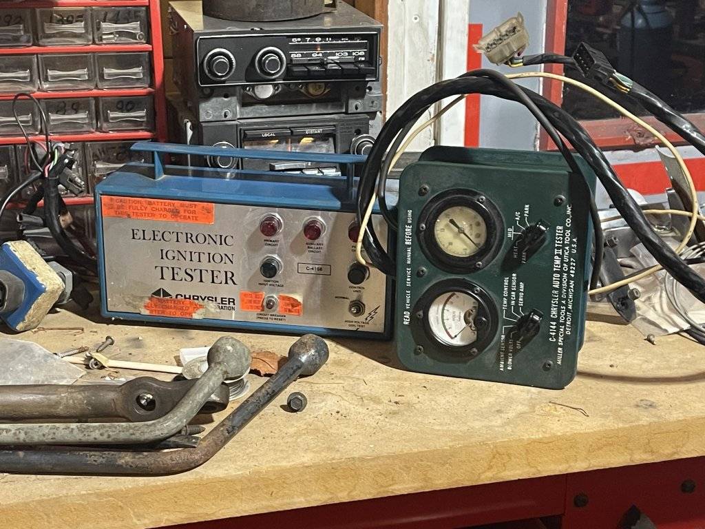

Here are a couple new tools I acquired that are essential to caring for vintage Chryslers like 72-73 Imperials. I will be testing them and making sure they work.

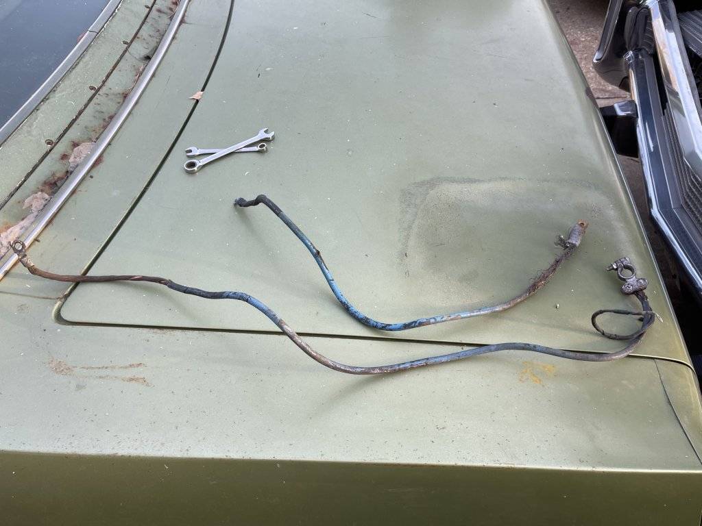

The 1972 and 1973 Imperials are very similar but very different at the same time. One way they are different is the length of the negative battery cables. Both are originals, look at how much longer the 1973 cable is. The 1972 cable is from a 11/24/71 build and the 1973 cable is from a 01/18/73 build. My brown 72 Imperial (build 03/15/72) has the same long cable as the 73. I will be sending off to get the cables remade by Evan’s Wiring, finally after all this time.

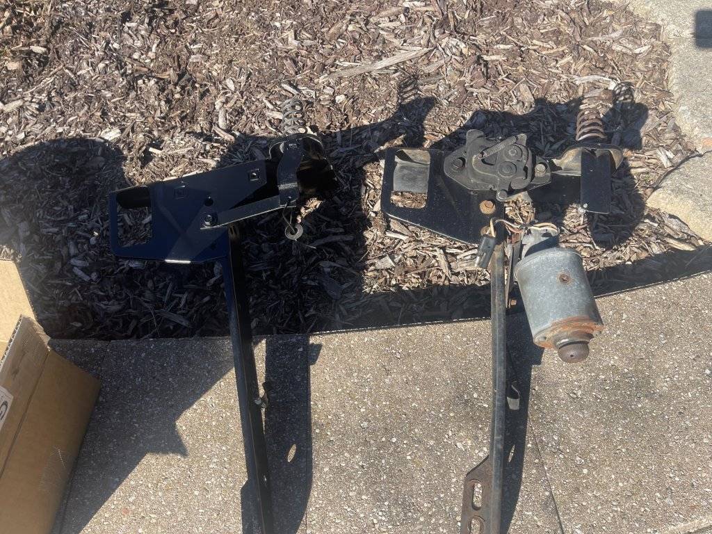

You can see on 1972 Imperials there is an early and a later latch tray design for the hood. Early is August and September for sure, it is the one with the lateral brace.
By November they switched to a cheaper design that is not as desirable, it lets the hood release cable flex too much.
