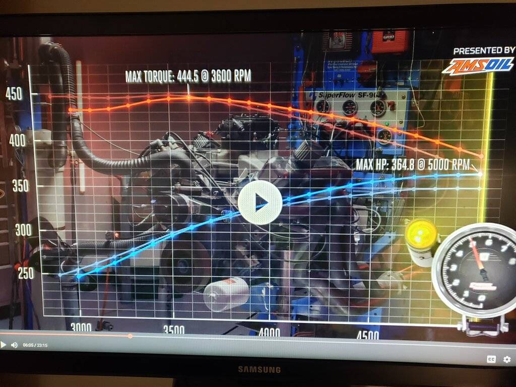

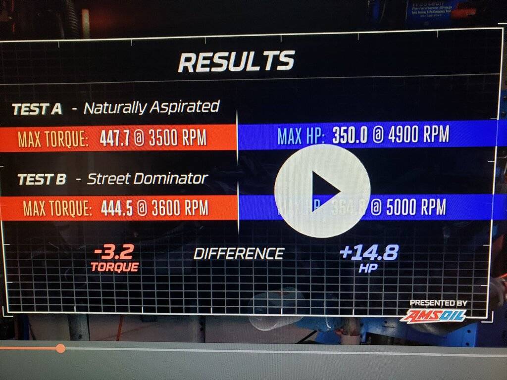

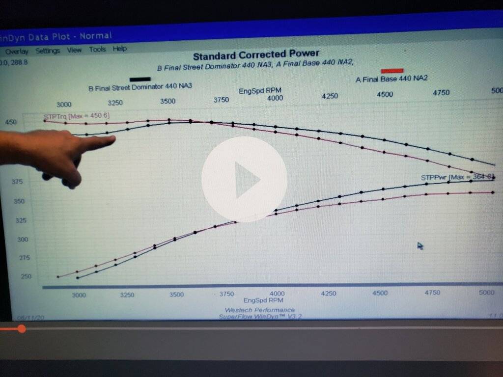

Interestingly I just watched engine masters episode 66. It was about turbocharging a low compression 440. The point I found interesting is they did a baseline NA before the turbo was installed. They had a Performer RPM which they tested NA and went to a Holley Street Dominator NA because they wanted to use that with the turbo. The results were very interesting. In my crude fashion I just took pictures on my screen to post here. That is not my finger LoL.
The Black line is the Dominator
After the merge at 3700 rpm the Dominator starts pulling away but the RPM had a bit more torque till 3600 or so.
Their final results. Not arguing here but they are similar and each manifolds strengths are the other's weakness if you can call it that. Maybe the Dominator doesn't work well with the smaller 383. I had read the 383 was not as well regarded as the 440 intake. I believe they discontinued the one for a 383 but could be wrong. Final HP for the Dominator below is 364.8 as above. Since you described your car and have a 383 i would think the eddy would be better. Just thought it was interesting.

DISCLAIMER! My above post maybe no good because after reviewing the video again they state the Eddy intake was in their words "The base performer 440 intake" so it may not be the RPM. My apologies.
