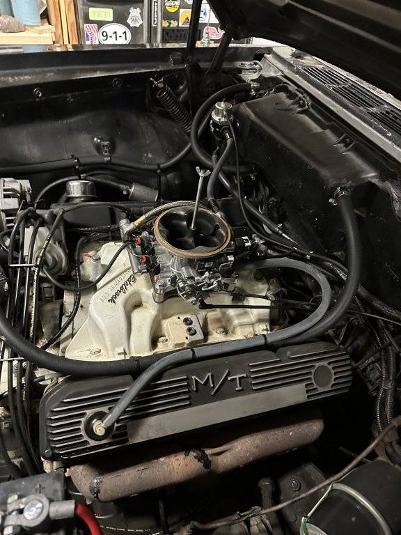

Well I finally have an update. I don't know if it was the new Edelbrock RPM intake or the new cam (0.020" more exhaust lift and 13/14 intake/exhaust less duration), or both, but what a difference! It is so much more fun to drive, has great low end torque, idles great and starts great. The changes met all my expectations.
