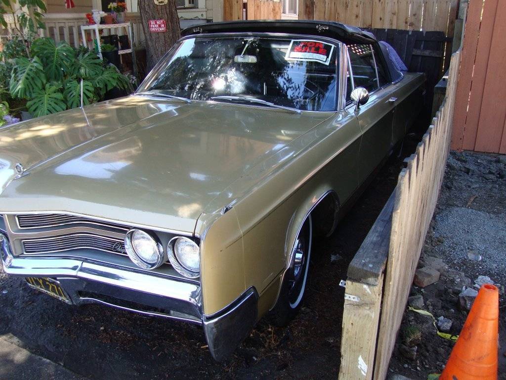

it called a '' used car special '' buffed back to it former gleaming glory . i never used an orbital type , mine looks like a old school grinder , keep a tool to clean your pad with , alot of matl (paint n mix) will plug up your pad . i use a screw driver blade , fire it up and drag its tip across the pad . fluffs the pad as well . if you do some hand rubbing around the tight stuff , trim and moldings emblems you won't get cot working hard around them , all ways the chance catching your pad on them , it can bend or rip a molding up .
this survivor was just done by hand , it could have gone under the buffer although . original owner kept on cover i the garage . wore through the paint on the high edges .
