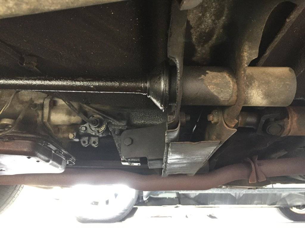

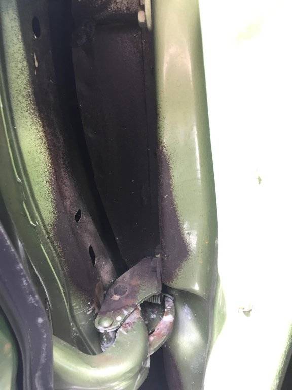

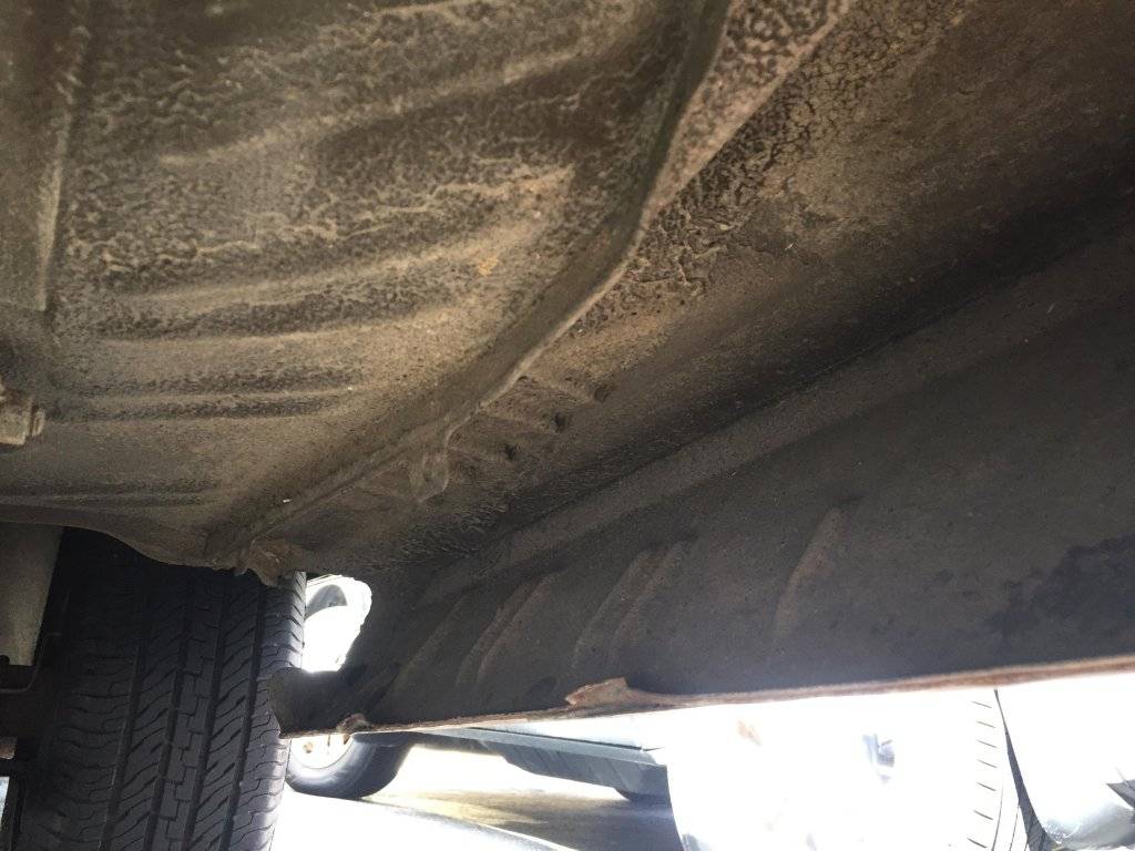

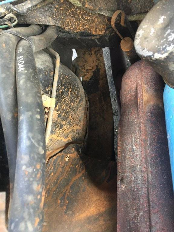

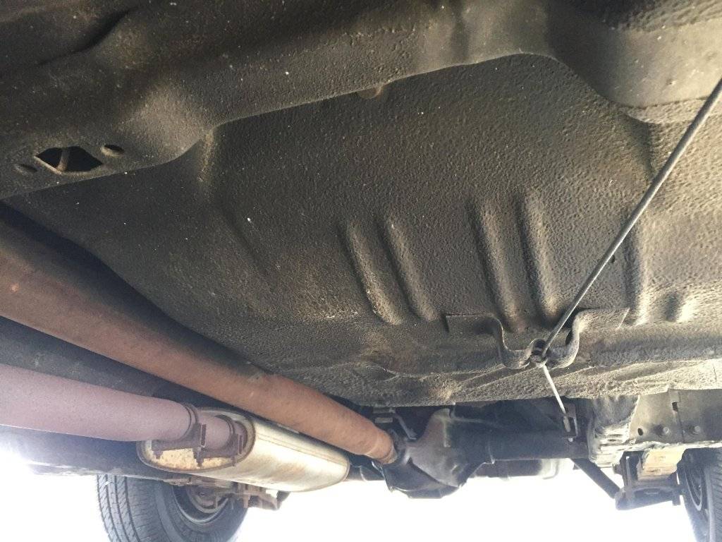

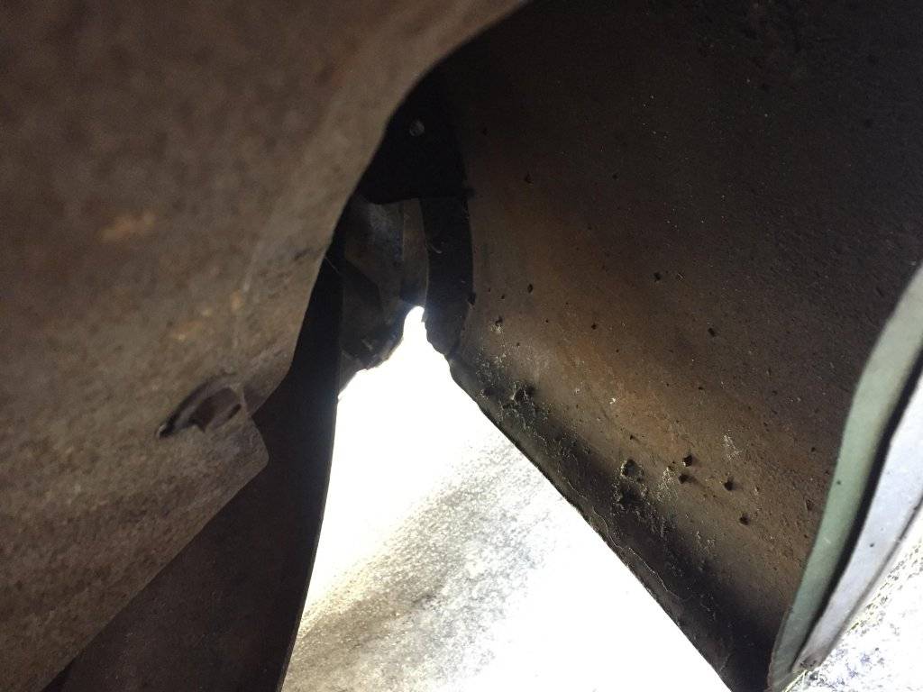

I don't see any nasty-looking rust on the underside yet. The panel interiors look solid still! Has this thick black truck bed liner-like coating on a lot of stuff. Thoughts?

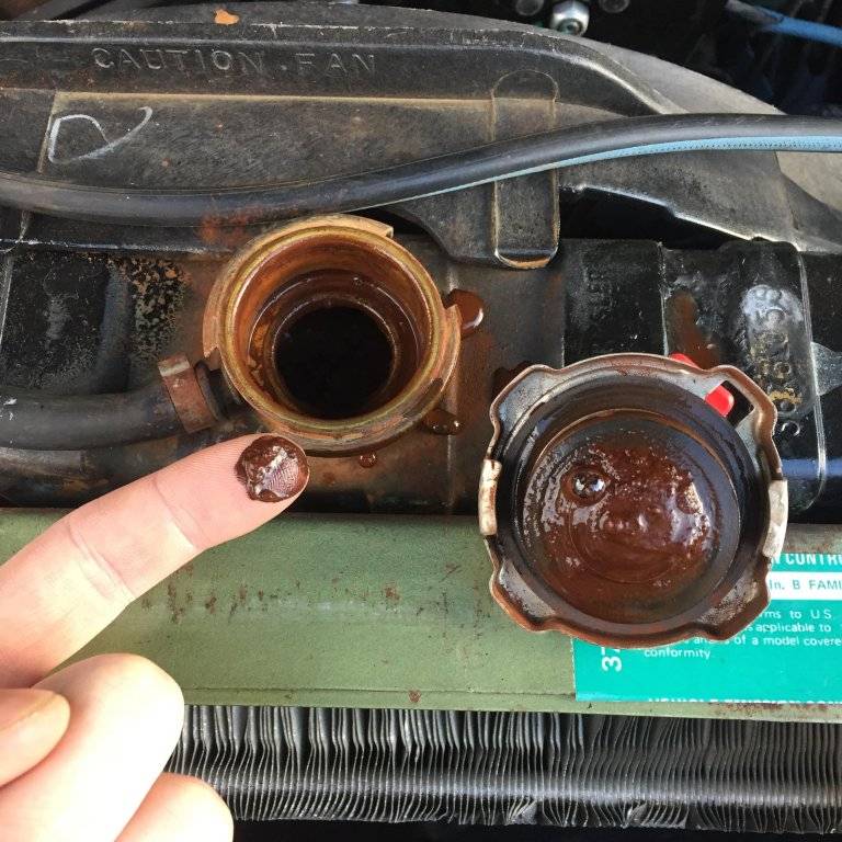

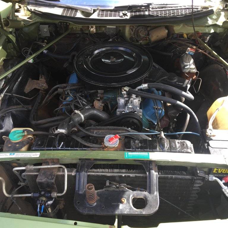

The worst I could find was in the engine bay. The original owner had a radiator cap recently blow off. I guess some rust in the radiator line. Maybe time for a flush?
let's hope this isn't a terrible sign?
Radiator flush time.
Check the trans fluid. Make sure there is no coolant mixing with it.
If so, the trans cooler at the bottom of the rad may have failed.
If the coolant is that dirty as shown, knock out the freeze plugs to really flush her out. You will need new freeze plugs to do this.
Just guessing at this point.
Hope it helps.
Hope it helps.
Transmission fluid looks nice and red on the dip stick. Nothing weird so far. I didn't even think about that being a possible issue!
Process of elimination,lol.
Being that dirty, do a reverse flow flush on the heater core as part of your coolant system flush.
