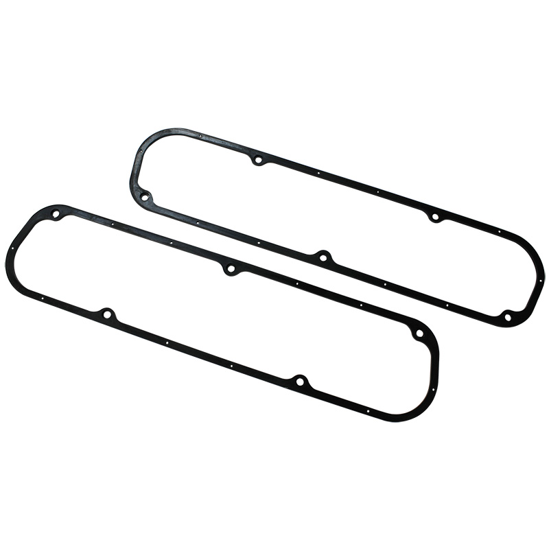

If this is for an LA block, I was looking for exactly the same thing a few months ago, specifically looking for a gasket with a steel core. I had done some work on my '01 Ram a couple years ago (318 magnum engine) and it had steel core gaskets from the factory, which I also replaced with new steel core, but the magnum engine has 10 bolts to hold the cover down, not a measly 5 bolts.
Anyways, I did find that Competition Products was selling a steel-core small-block gasket for the ridiculously low amount of $17. Practically the same price as some cork gaskets.
I have put them on the car but haven't tightend them down yet as I've been cleaning up the valve covers but they do fit. But a word of warning. THEY SMELL. I had them in a small storage room for a month or two and I thought I had mice in the room or a cat peed in the room because over time the smell grew stronger, like mouse pee or that barnyard manure smell. They were in a cardboard box, not taped up or anything.
They seem to be made of rubber, it's not overly hard or overly soft rubber, they are thick, maybe 3/16 thick, and the steel core does make them very stiff, they hold their shape.
Why the smell, I don't know. I have a feeling I'm going to be wondering if mice got into my car every time I lift the hood now. Strange.
