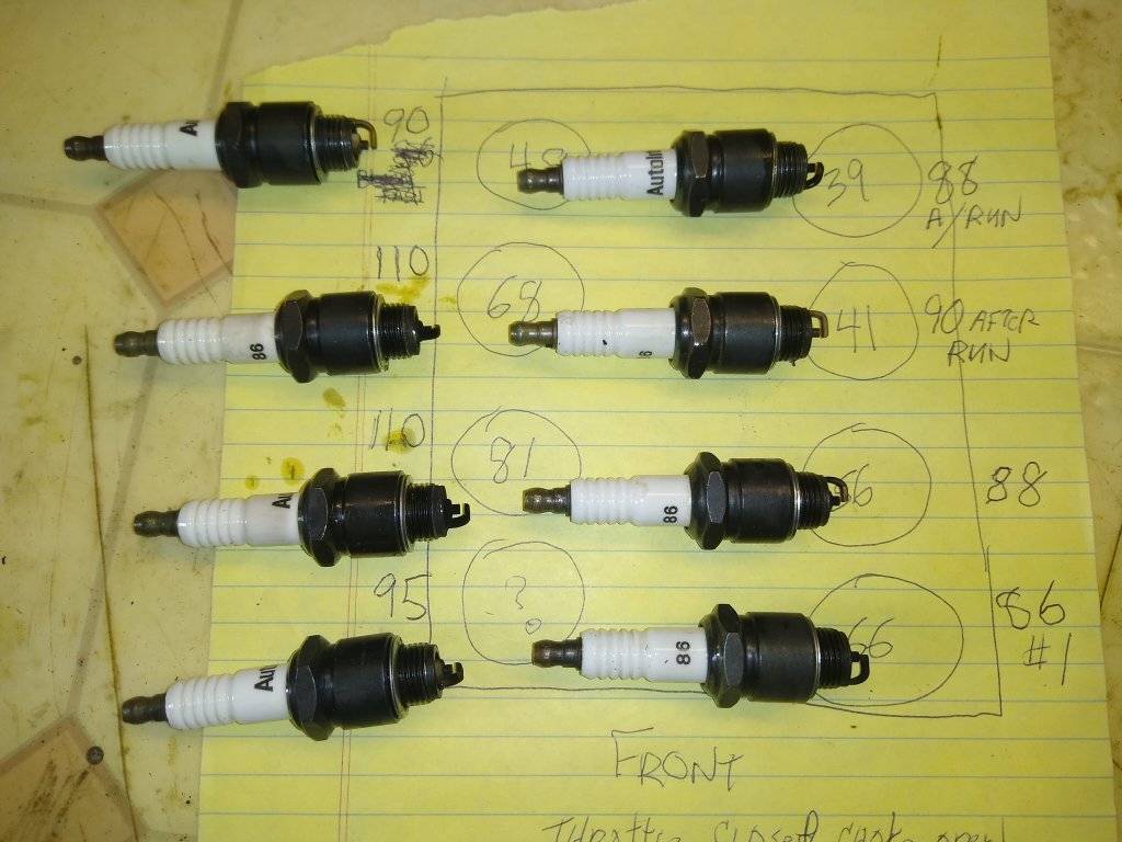

Keeping in mind that the engine has NOT been started at all I did a compression test. The numbers run between 39 and 81 psi. After the test I got it running but seems too lean and would run best at full choke when warm so I'll be looking further into the carb. Vacuum gauge hooked to the base of the carb shows in the green and about 1500 rpm. No blue or black smoke. Checked for vacuum leaks with carb cleaner and found one, but didn't seem big enough to cause the lean condition. I'm hoping the rings were replaced and they just need to be run in? After I get it running better I'll check compression again and recheck the valves while warm. Will keep you posted.

I've got to take a break today from this. Good news is after running it up to temperature at about 1500 RPM and checking compression again, they are in the range of 88-110psi. My gauge is old so I'm looking into getting a new one. Weird thing is that it will only run with the choke closed (too lean) but only 2 of the plugs are clean and the rest are black? Go figure. I remember when I had an old Harley the plugs could "foul" and not fire any more. I won

I've got to take a break today from this. Good news is after running it up to temperature at about 1500 RPM and checking compression again, they are in the range of 88-110psi. My gauge is old so I'm looking into getting a new one. Weird thing is that it will only run with the choke closed (too lean) but only 2 of the plugs are clean and the rest are black? Go figure. I remember when I had an old Harley the plugs could "foul" and not fire any more. I wonder if that's involved and I think this rebuilt Carter WCFB 2302SA carb needs looking into. While it was running about 1500RPM I screwed the idle mixture screws all the way in and it made no difference. Maybe that's normal at that RPM? I tried putting my hand over the primary on the top of the carb and about lost my hand from the suction!
The idle system ONLY works up to about 1000rpm or so, which is when the main system takes over for higher engine speeds. So what you found is probably not unusual.
If the bulk of the plugs are sooty after running with the choke pretty much closed, look to see if the ones which are clean are on the same air flow route and which side of the carb they are fed by. Seeing the differences in the plug ceramics, I suspect there is a big crack somewhere in the carb or the intake manifold. Seeing which runners those cyls are fed from might yield the key?

The clean plugs have the vacuum leak or no fuel from the carb. Good advise above, look at the intake and see where the air fuel comes from.
