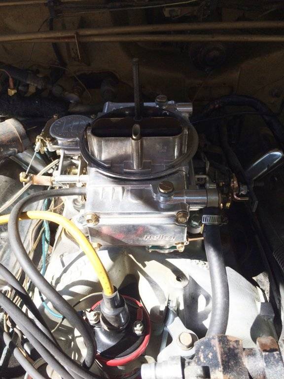

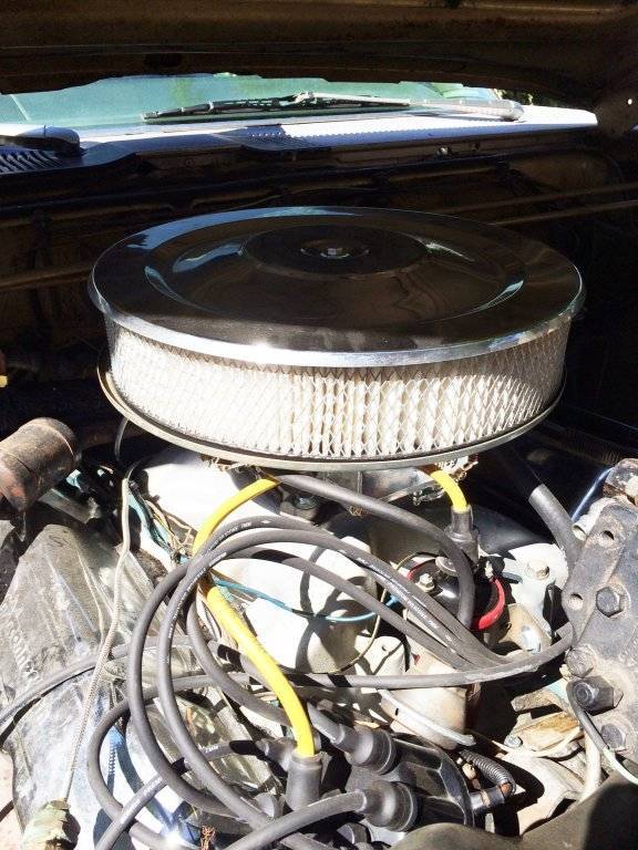

I used to run one on my '66 without a spacer and it had plenty of room. If you'd like more pictures, let me know.
