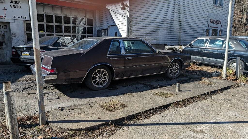

I did happen on a cheap '81 Imperial. As I mentioned in Charles thread it's rough, but hasn't had 20 different assholes cutting, modifying, "fixing", when in reality they don't know their *** from a hole in the ground. So I don't have to unf@&k their work.
Yes, I know those are not the right wheels(just rollers), I have the steel wheels and 4 Chrysler spoked hubcaps, 2 with imperial center and 2 with large pentastar, on the lookout for Imperial centers.

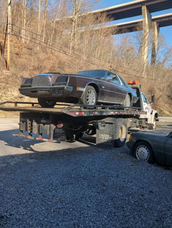

Picked it up Wednesday

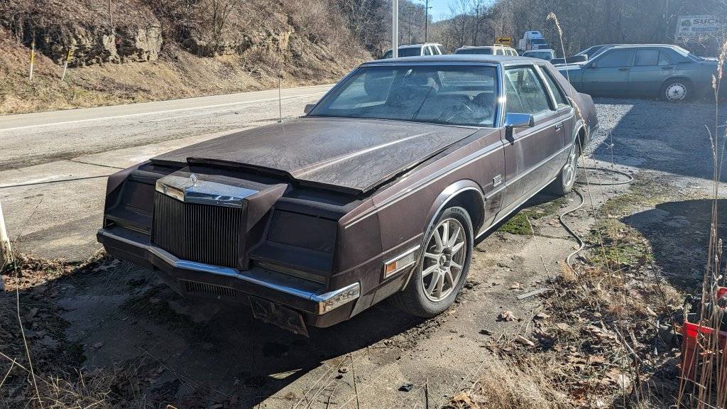

So today after work threw a battery in it and twist the key. Nothing, dammit.

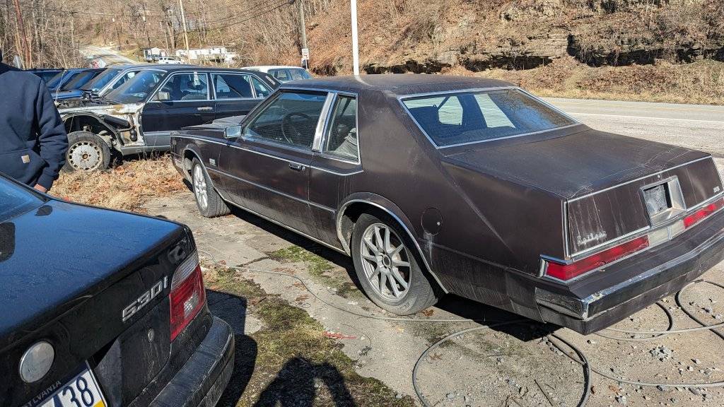

Add booster, cranking, add fuel from bottle and we got fire, yaaaay. So ran it for a whole 16 oz bottle of gas. Throttle blades are stuck somewhat open due to my foot stomping on gas ( if it breaks needed replaced anyway). Turns out potting material from module in air cleaner oozed down through throttle plates. Cleaned got them moving. Added coolant we will see if that stays or leaks out somewhere.
She needs a bath.
So here is the start, more to come.

It's kind of a simple system, but info is spotty and there is no diagnostic port, just voltage checks. There is no common flow chart on them. I have engine and chassis manual so I'll have to read a bit. Still may try to see if it works if I can get some correct pressure fuel to it. The melted potting leaking down into the throttle body added a lot of aggravation to EFI.
I think the 5.7 Hemi is where I would like to end up, and as far as 3rd gen Hemi's go it's a '04, so pretty undesirable for hot rod stuff, perfect for a luxo barge.
