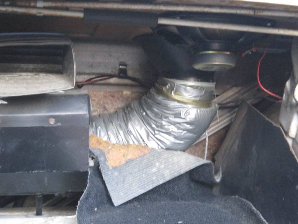

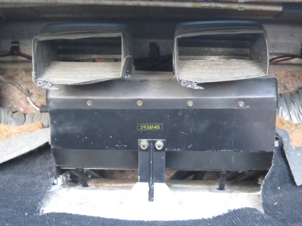

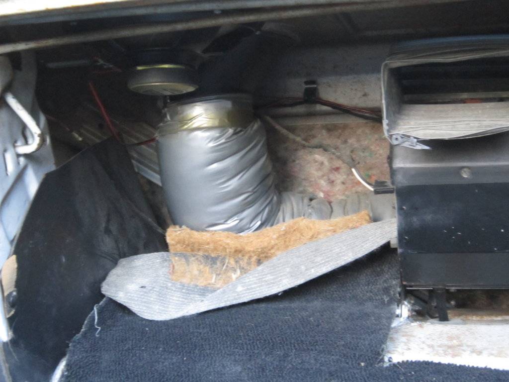

Dual AT? How can it have the rear heater/defroster that could burn unlucky passengers` necks then? I spotted RR heat button on the dash.
I don't know, the heater/defroster "probably" operates through the Airtemp unit as the ATC is an early version of today's climate control systems.
Look at the rear of the trunk right behind the seat as that's where the rear A/C evaporator is located.
You`re right, so it is the rear A/C, which works.

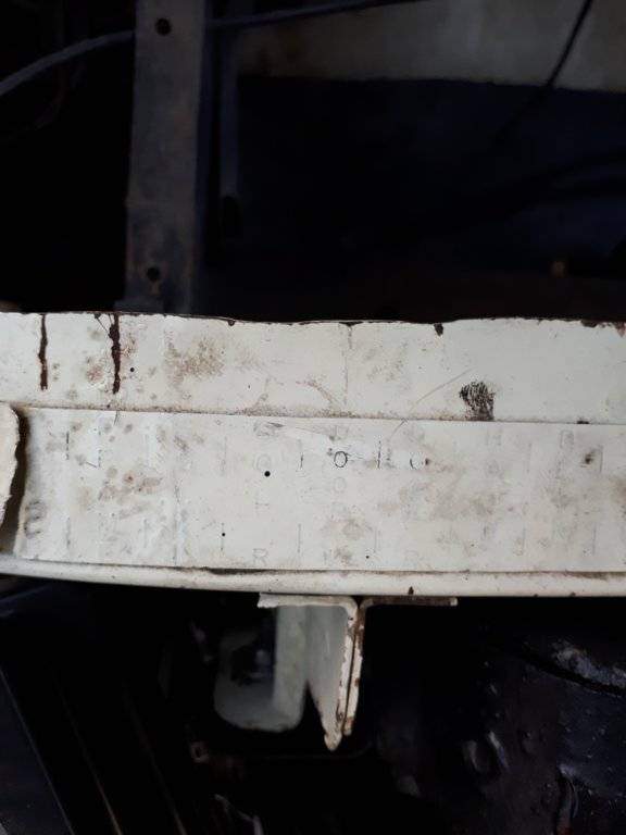

What are these? the pad is next to the fender tag, but the codes are pointing to the windshield, so I had to spin the photo.
