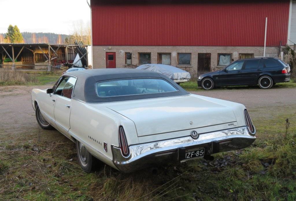

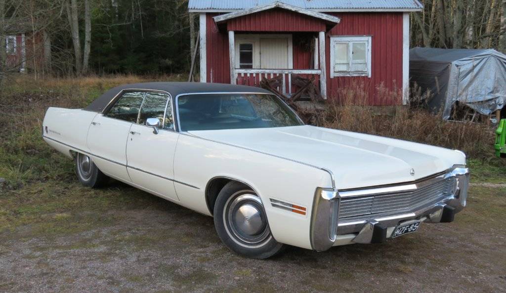

Impster - the big&white

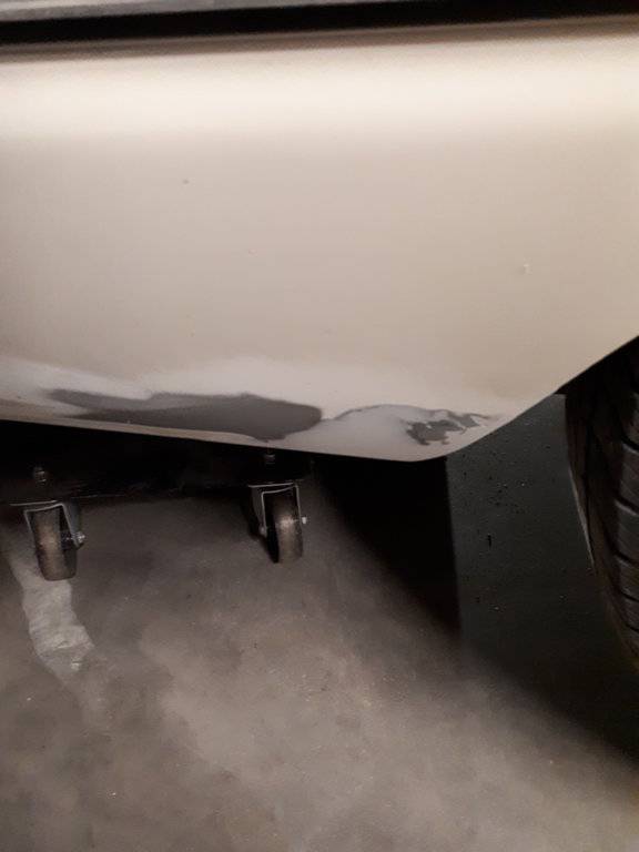

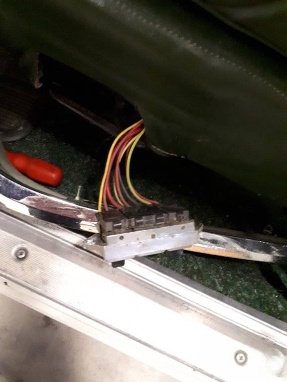

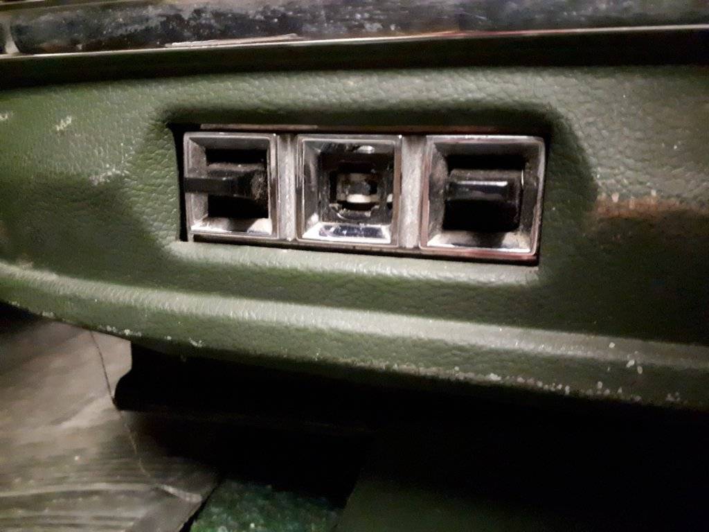

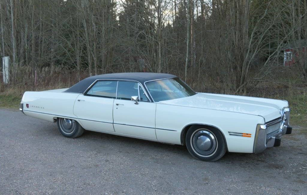

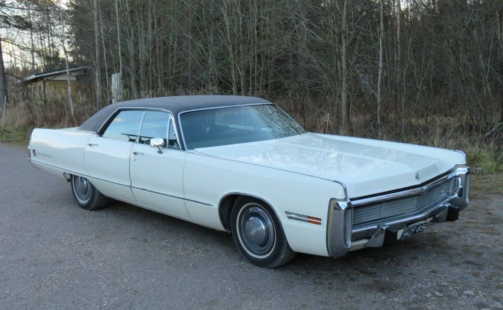

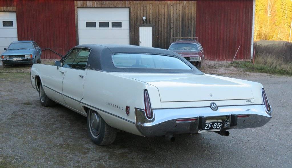

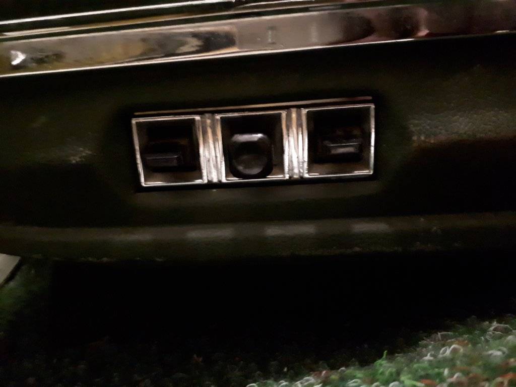

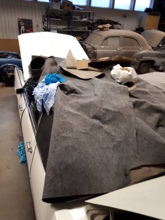

Some progress: I replaced the power seat switch, my dad helped to sand the rear quarters and we were making a plan to get the head light covers move as they´re supposed to. Thank you @73 T&C for giving me the good instructions to change the switch easily.

Looking good. Love the videos and pics. You gonna keep working on her throughout the winter months? Or does it get super cold in Finland garage?
I´ll be working trough the winter. It depends on the garage, how cold it may get, but the one, where Impster is gets to about plus 7 degrees Celsius at the lowest.

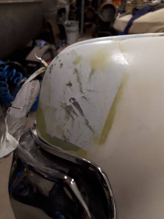

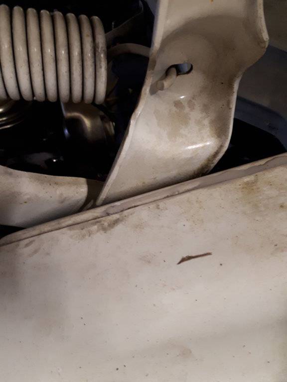

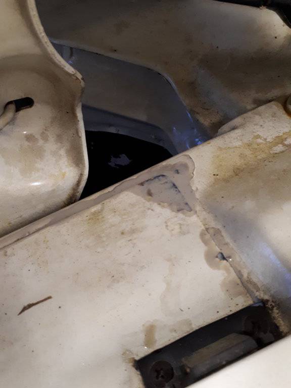

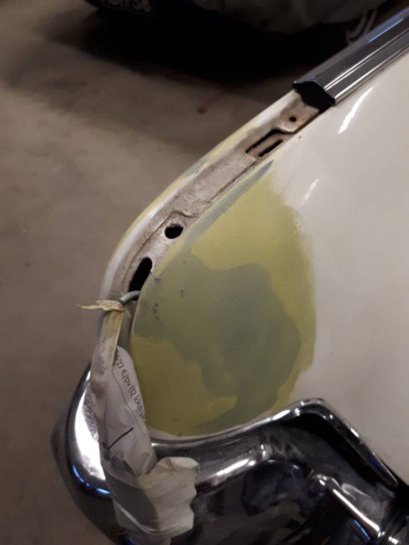

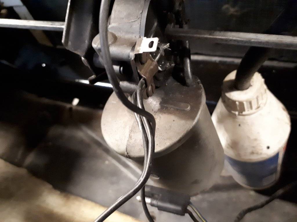

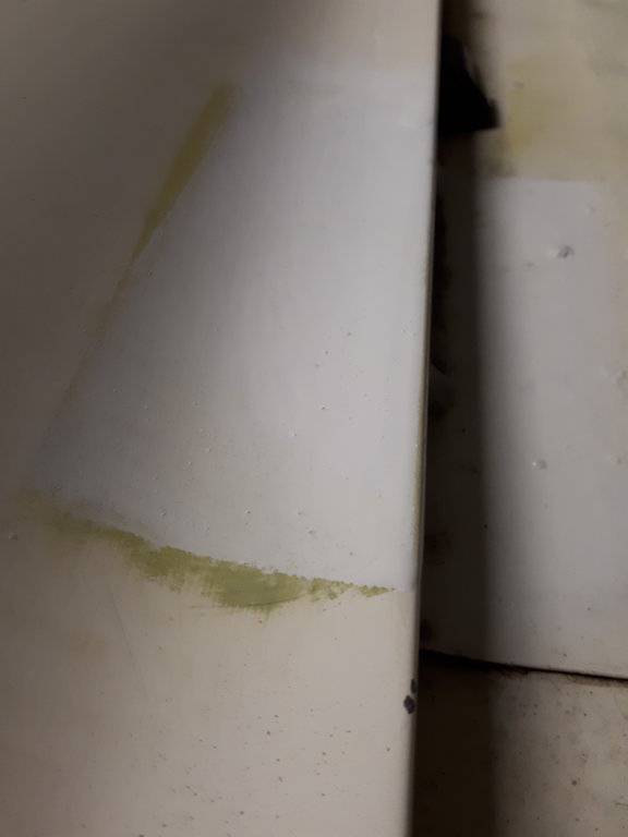

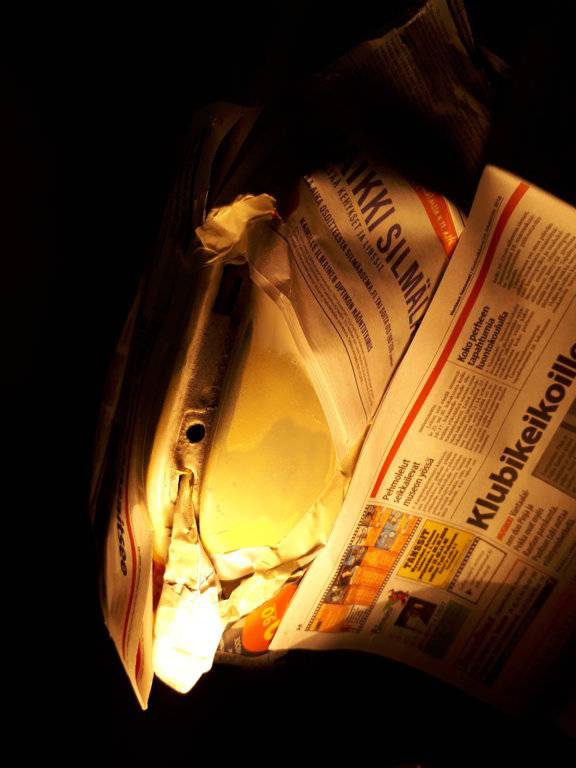

Today´s visit included more sanding, some painting and scrubbing heads about how to get the headlight motor out. The paint on the fender tip failed, but it´s only the first coat of white (not even the right shade yet) to see possible flaws.

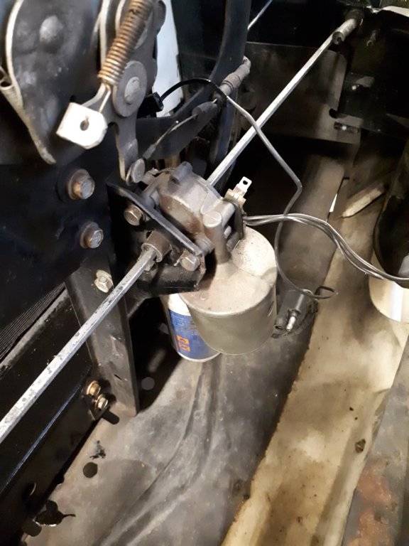

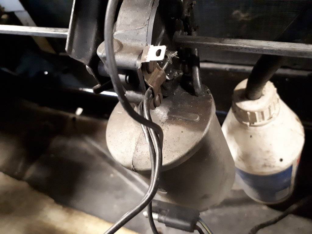

@DocMcNeedy, I haven´t forgot that Herd goes at the shop, but do you have tips to get it detached? I should change the limit switch, which restricts electricity when the covers should go down.

That grey-like coating is rust converter.

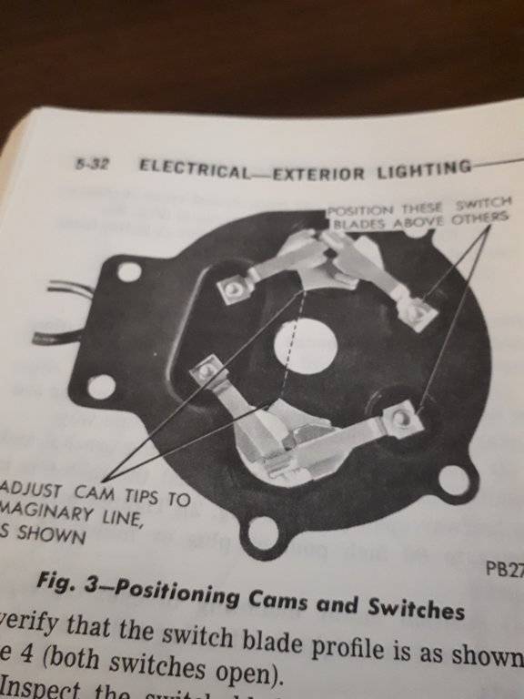

Did you refer to the FSM yet? Haven't checked to see if that topic is covered in the manuals.
I have the BSM, but it shows the procedures with a 70 Chrysler 300, which has different components. Otherwise I´d follow it.

For @detmatt: I think that the automatic headlight system does not work, because (at least) the needed amplifier is missing. In Fusies it should be installed behind the grille and right next to the LH side dual headlight unit.

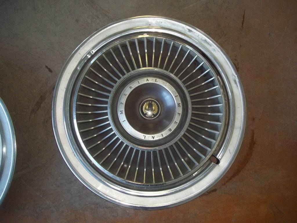

Here are the two options, of which I´ll do the decision of ``new`` wheel covers:
So either a set from a 69 Imperial or wire wheel covers seen on many Mopars back in the 70s (I´ll stick on 15´´).

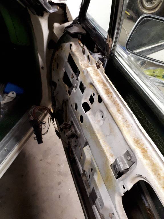

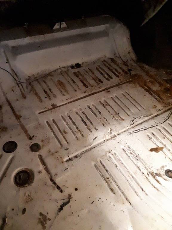

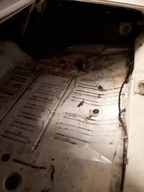

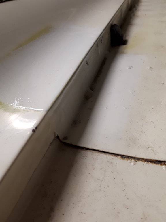

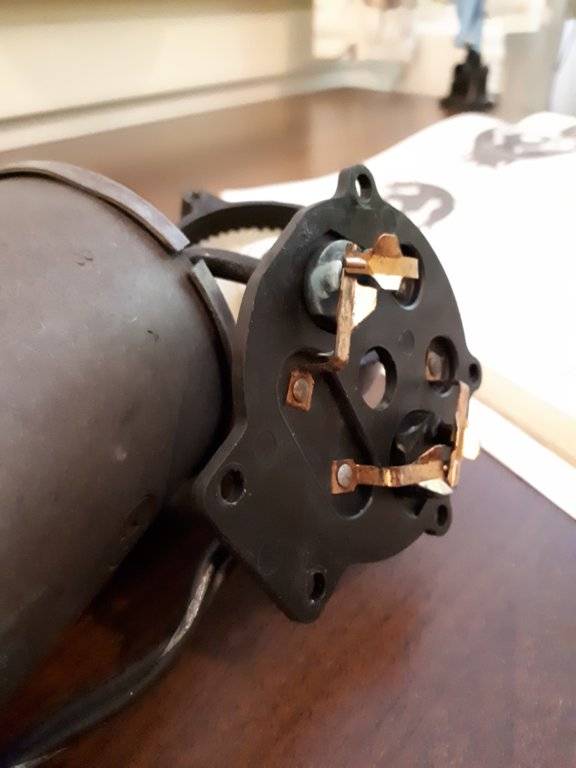

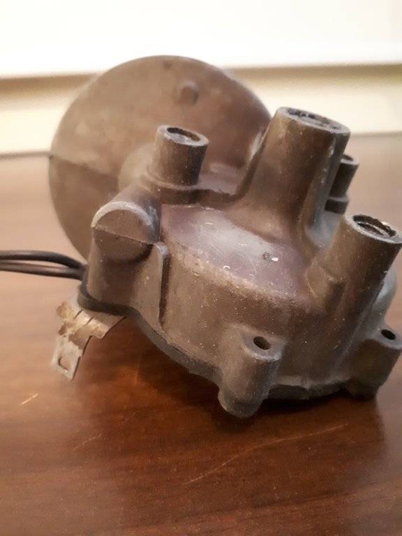

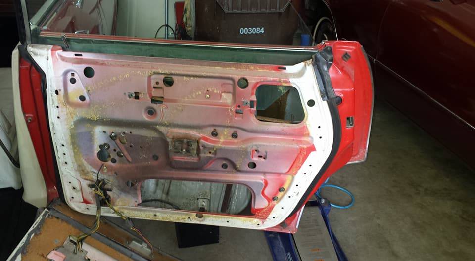

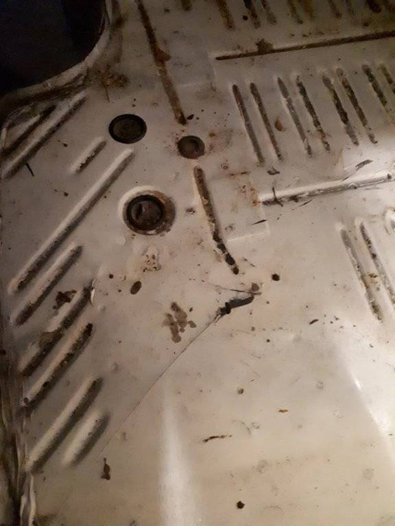

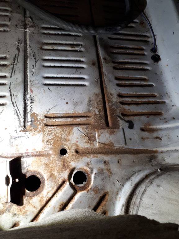

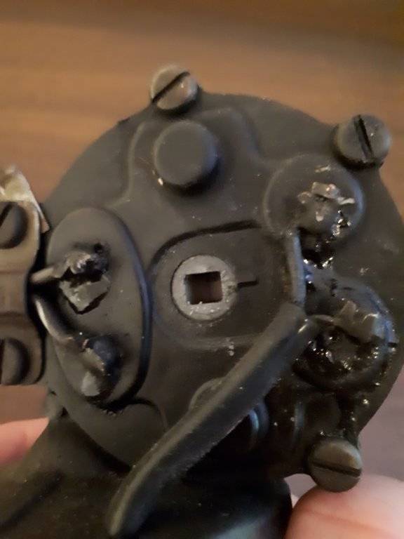

We got the headlight motor off today. It came out easily after warming the covers with a heat gun and then using pliers to get the torsion bar loose. Dad was again sanding the rear quarters, when I took all the stuff out from the trunk and brushed it with a steel brush. Some spots of the trunk pan are now covered with rust converter before getting it all the steel protected and painted. Good is that the trunk pan is solid and it has only surface rust. We also took the right front door panel off to get the vent window back to life.

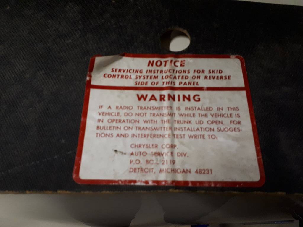

The bumper jack cover has some interesting bits of information and I´ll go with a set of Imperial wheel covers, which I´ll buy from Matt when the mail system is working normally again. This pic is blurry, but still readable.

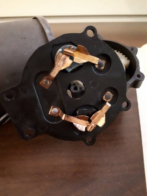

The headlight cover motor seems to be an easy task. Its internal parts were misaligned.
