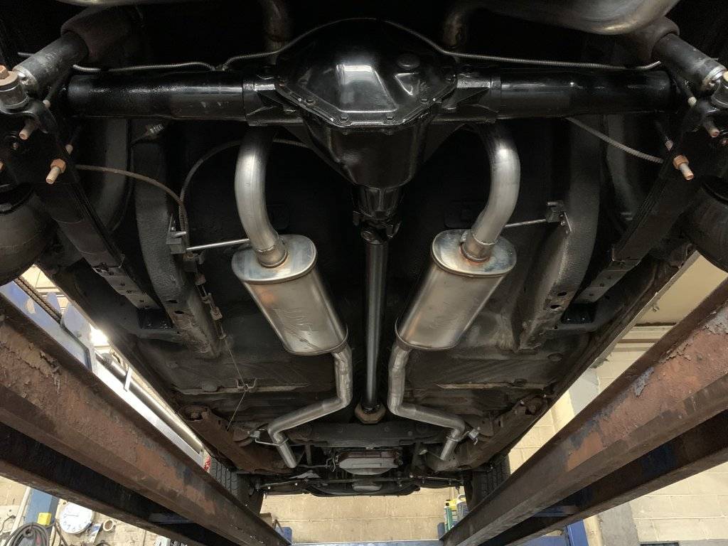

I just installed duel MagnaFlow (12256) on my 77 NYB… and they sound AMAZING In my opinion. Got that nice Gurgling at idol. And No droning at highway speed. Yet when you accelerate you know they’re under there. As Mr. Plant mentioned, the length of the Muffler Case has allot with how loud or quite it’ll be.. just my 2 cents.

Sexy pipes... John
agree. those are some damn nice pipes. noticed the tail pipes are hung from the sides of the frame as they should be. allows the pipes to be hung up tight to the frame. the would have done a lot of justice to the whole system though if they had contoured the hangers to the pipes before welding them. but my compliments to the man who bent it. nice job.
