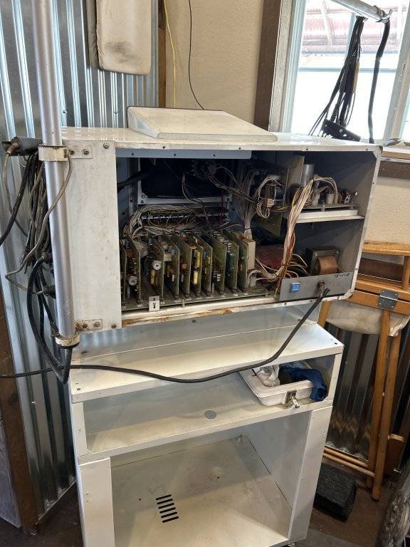

New project: Allen Engine analyzers, restoration?

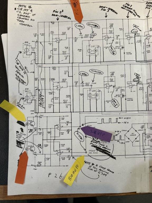

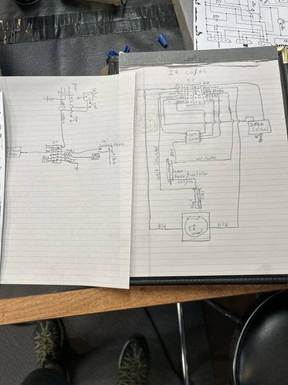

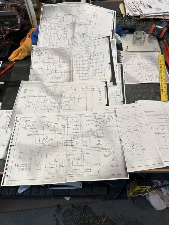

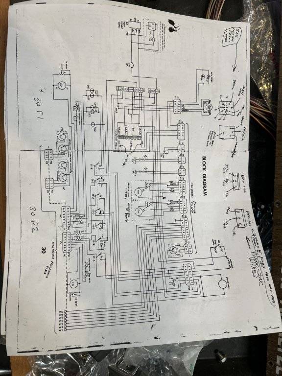

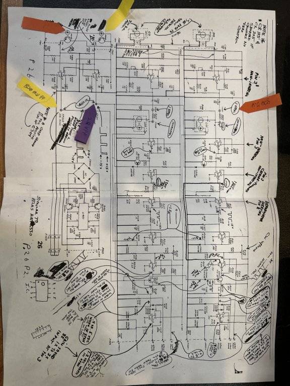

The start of my rudimentary schematics. I am sure that my diagrams of components don’t meet any electrical standards. I need to draw mine out and then see if I can translate the factory schematic that is closest to mine so I can troubleshoot.
Thanks @1970cat. It seems I already have most of what pertains to my machines already downloaded in my file. So one thing I need to learn is the difference between "lunch box" and " bathtub" type analyzers. My first thoughts are that the "lunch Box" type are portable? and the "Bathtub" are console machines?

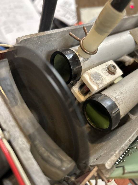

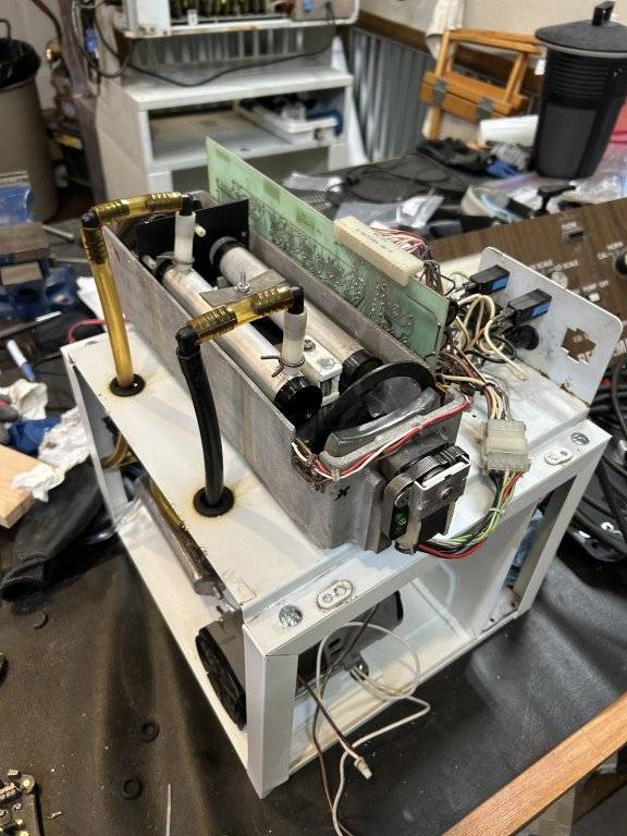

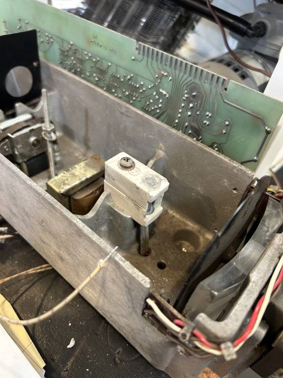

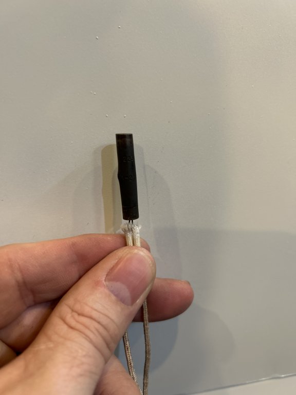

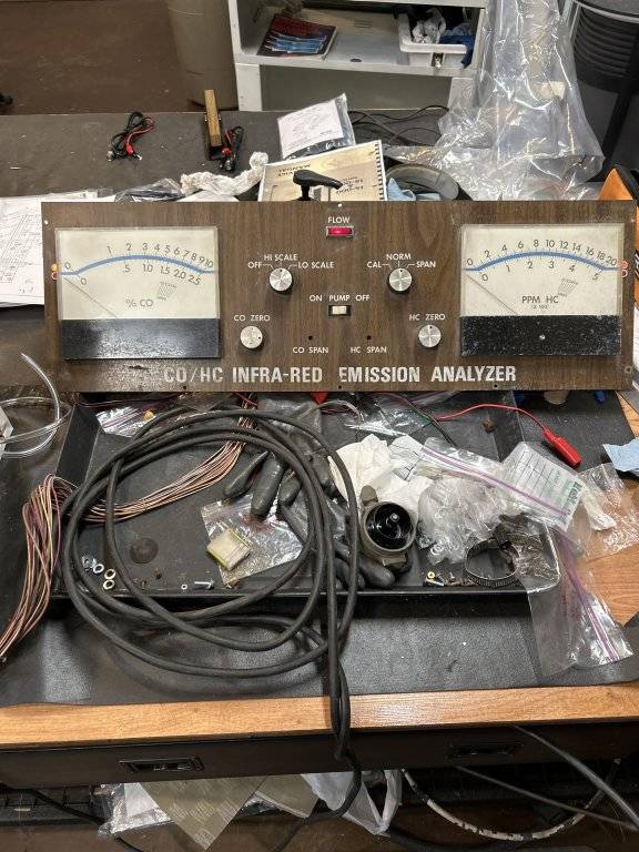

Still hitting a brick wall on the exhaust side. Early on I had what I think is/was the heat/IR source glowing. Now nothing. I checked the circuit which is fed by full power, it has power (as it is shared the voltage regulator which works). It flows through a 33 ohm resistor(I believe to heat the tubes to prevent condensation) then onto the “glow plug” of which I cannot find the resistance spec. But the resistance through both is 53 ohms. It’s in series which leaves about 20 Ohms for the plug. So not shorted. But is 20 ohms enough to make a metal rod glow?

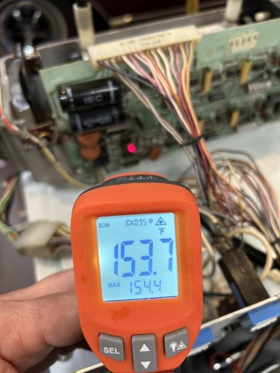

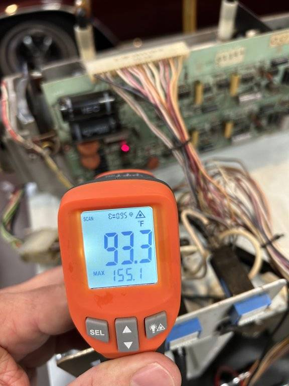

On a whim I decided to take my Infrared thermometer across the chip board. Almost everything on the board maxed out around 94 degrees except for one chip which on one tang was at 154 degrees and the other side was about 124 degrees. So maybe that chip is shorting out? I may be going down a rabbit hole. Maybe I need to isolate the plug and apply voltage to see if it heats up? My thoughts are that something on the circuit board is not allowing the circuit to go to ground to heat?

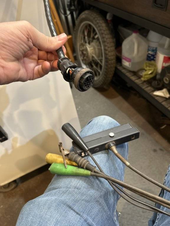

By the way I fired up the oscilloscope to check out @Polara_500_Jr car when we adjusted his new carb the other night. When you learn to read the tea leaves (scope), you can finally answer the question - ballast resistor or fuel? Is it coil wiring, is it a plug wire? What cylinder is causing the issues. Is one bank richer than another. You can even shut off spark to half of the engine. I love it. I need to get it totally fixed including the gauges.

I can try to analyze the circuit, but tell us what the problem is or how it’s behaving…
See a couple of posts ago where I explained some of what is going on. When I start it up the gauges peg. The HC gauge pegs and goes directly down to below 0. The CO% gauge pegs and then slowly goes down. In about 3 minutes it is below zero on the gauge with no calibration adjustment. I have power to the panel regular 120 V and 40V regulated. The switches seem to work to transfer power to the correct circuit as stated in an above thread. There is a (glow plug) my term that is no longer glowing. Some notes in the books I have say that if the gauges don’t zero, there is something wrong with the analyzer reading circuit.
