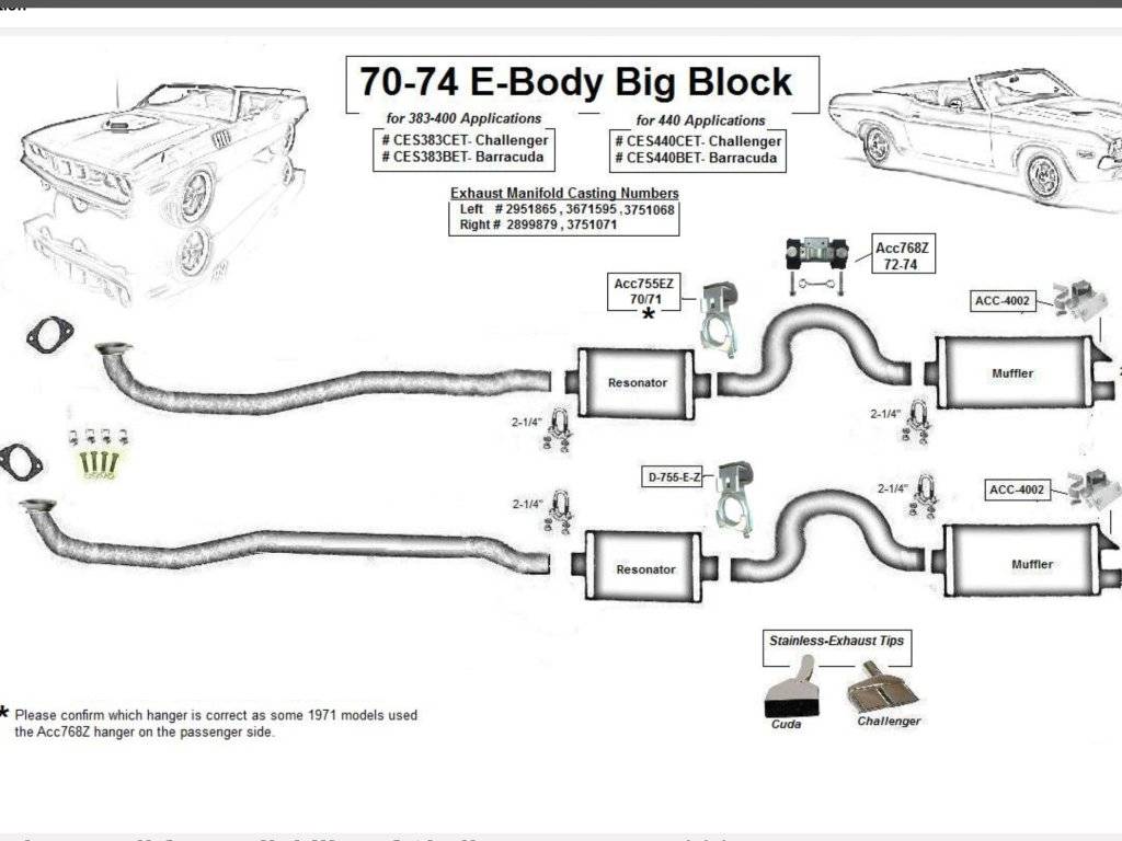

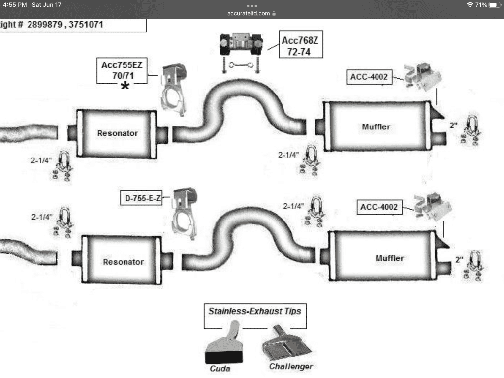

The resonators are under the rear seat, the muffler is in the tailpipe. Here is the Accurate LTD exhaust page on it.
(see option box below) -70-74 383/440 Big Block Complete Exh
Yes, that is the way the E-body exhaust system is. C-bodies have the longer mufflers under the rear seat and the round resonators near the gas tank.
Mine look like the ones in your first link:
To me, the first cans under the rear seat look like mine and the ones under the trunk look round like the ones in your photo too. To me, the first cans look like mufflers and the rear ones look like the usual round resonators. In any case, what's on my car sound just right for that car..................

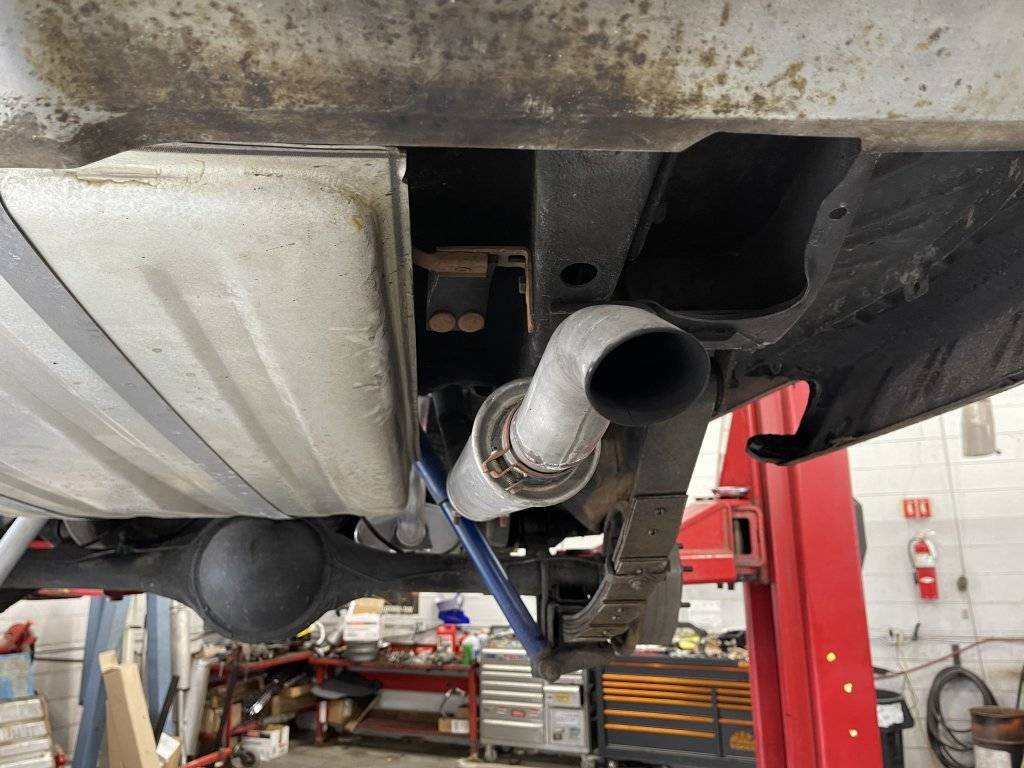

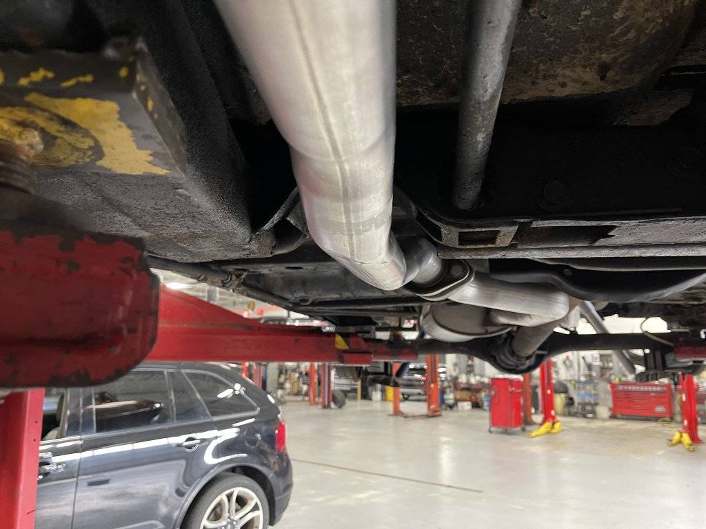

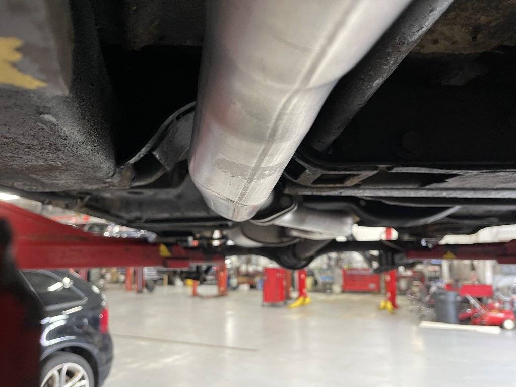

I had tried to load pictures of the installation for a while. It ended up on my newest 72 Imperial and now that everything is installed I hate to say that it is extremely disappointing.
The flat on the y-pipe at the crossmember is not parallel to the ground, but cocked sideways.
The resonator is fulled butted to the over the axle pipe and it sits too far back to line up with the stock hanger and camp.
The resonator is also not even aligned to the car correctly. It swings outboard at the end of the car and lines up with the frame, not inboard of the frame as it should be. I had the tip modified to make it come closer to the bumper, but even that did not fix my concern.
In conclusion, Waldron: do better. This stinks. I have contacted them to share these pictures and give them feedback.
