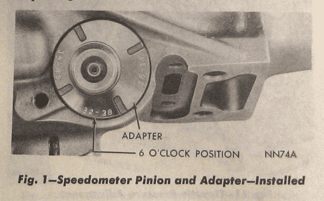

Just to be sure, the "26-31" is at the 6:00 position. This FSM pic shows "32-38" in the 6:00 position.
There is a little free play in the clamp, so you may want to try turning it just a little with the cable off and see if it engages better. I think turning it clockwise(?) would force the speedo gear into the worm gear on the output shaft. Try counterclockwise too.

Yeah it’s in the correct spot. I’ll try your suggestion of slightly turning it.
