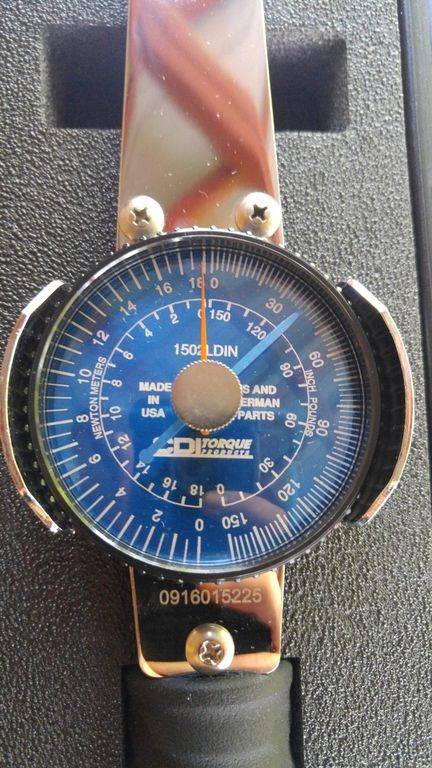

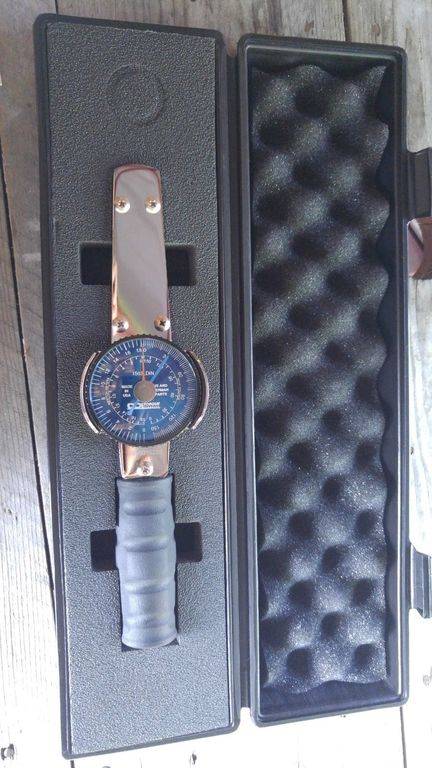

I was partners in an A2LA accredited calibration lab. We calibrated literally thousands of torque wrenches (along with a lot of other stuff).
If you want to buy an inch/pound torque wrench, buy something like this with 0-150 in/lb range. Use a 1/4 to 1/2" drive adapter or 1/4 to 3/8 and 3/8 to 1/2" together.
