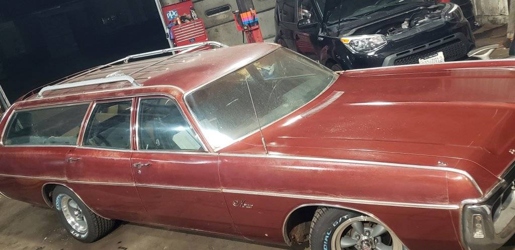

I talked with @halifaxhops, and after examining some pictures Wyatt sent me, we've concluded it's a ground issue. Wyatt will be getting over to his shop soon and scraping a little paint and will let me know. I'll have him check the shaft while the distributor is out.
It was a ground issue, some scraped paint and it got good ground. But a bad vacuum advance diaphragm showed itself, so a distributor will be coming from @halifaxhops in the near future.
