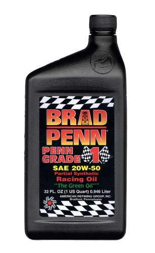

Brad Penn oil.
Mike, are you talking about this oil? I buy it for $60 for a case of 12.
http://www.penngrade1.com/
That's the stuff and I think Valvoline is making one that still has the zinc content. All the zinc is still in the diesel oils and its a bit cheaper.
If you're looking for zinc, use Shell Rotella Diesel oil. Lots of guys run it in their cars.
Caution: There's two Rotellas. One for diesels that have to meet the new EPA requirements and the Original Rotella T. You want the Rotella T.
