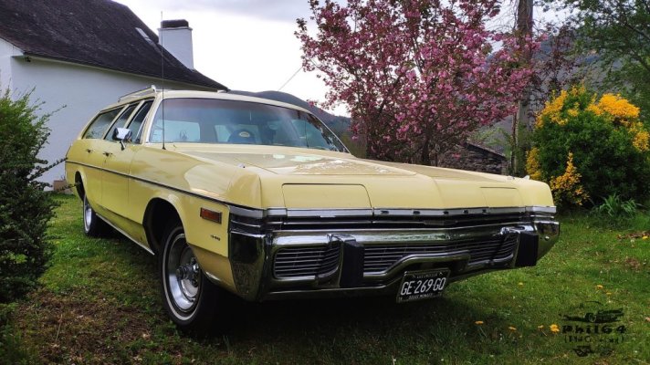

Hi all,
First of all sorry if there are spelling or syntax errors I am French but I try to do my best...
I owned this Monaco wagon since the summer of 2021, one of its former owners (if not several?) is on this forum and thanks to him I was able to trace it back to the son of the 2nd owner (approximately 1976-2014) so I know almost all its history except the first 2 years.
It is a very optioned model, there are almost all the possible options of 1973 ! I join pics of the option plates (there are two, not enough space on one !) and the broadcast sheet. I wonder how much the buyer paid on top of the base price...It no longer has the woodgrain according to the son of the 2nd owner the material was of poor quality and faded after a few months or years. But also there's no repros so maybe I'll leave it that way.
I am still not very satisfied with some points. I find that the 440 is very lazy, it is less powerful than a 318, no torque, etc ... I know it's a low compression engine so I'm going to put it back in the 1969-70 configuration next winter . Could also be a converter problem? The transmission was renewed (said the seller) recently. I'll open a new thread for advice.
I also have issues with corrosion of the rear cross member and body mounts. The seller was careful not to talk about it and the person who saw it and bought it for me did not inspect it seriously ... After when it arrived in France it's difficult to send it back!

Two things -- Wondering how a Monaco came to have Polara side mouldings on it, rather than the Monaco's woodgrain sections? The W23 15x6 wheels were not available on station wagons, only the 15x6.5 steel wheels with wheel covers. I verified this in www.hamtramck-historical.com in the "Library" and then in the "AMA Specifications" for the car. So, the wheels came later, at the possible desire of a prior owner. The "ordered car" notation could have been a real buyer's "special order" vehicle or a dealer that wanted a car for stock and didn't want the factory to know that was what they wanted.
The "AMA Specifications" has more information in it that what's in the factory service manual (www.mymopar.com), plus it's all in the listings rather than having to go through the service manual to find them.
It is a great looking car! Sorry to hear of the rust issues, though, but they can be fixed, I suspect.

Looks better without the woodgrain.
Indeed, some tell me to leave it as it is, others to put the woodgrain. I remain puzzled...
