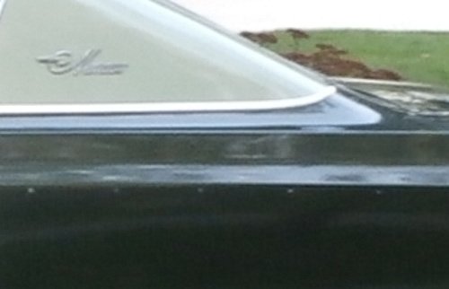

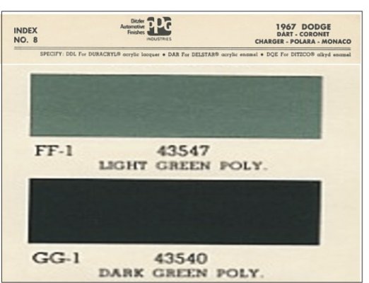

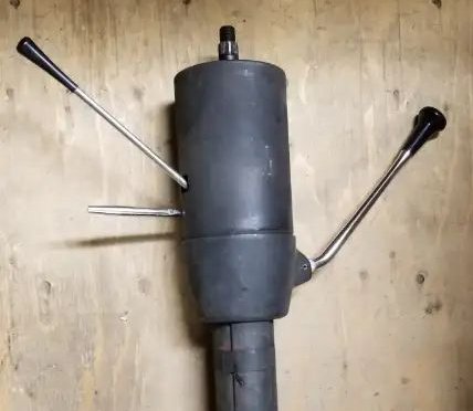

I'm going to be swapping in a tilt steering column. I need to paint the part of the column behind where the steering wheel mounts (not sure what that's called). It's currently painted black.
The car was repainted in 1987, probably a single-stage urethane. When the car came back, my dad was immediately not impressed - he says they got the color wrong (a little to dark). I also repainted the dash (the metal part) and I think I got the color right, but the car is now in storage and it's not coming out probably until May or June. monaco-paint.jpgmonaco-color.jpgtilt-steer.jpg

That job shouldn't be as critical for colour match new vs 35 years old for a couple of reasons. The steering column doesn't get anything close to the Uv exposure the the exterior does so it whould have very little fading from original. There isn't much around it the same exact colour to give it away unlike a hood or a quarter panel where even a slight difference sticks out like a sore ***.
If that's a matt finish, Mancini used to have the genuine Mopar paint for the metal dash panels but that was a while ago. Green being a less popular colour for the E, B and A body crowd, they might still have some left. An auto paint vendor can flatten paint but the texture won't be quite the same. Only a worry if you plan on showing at Pebble Beach tho. Lol.

The exterior column shell or housing, can it be taken off easily? That would be ideal to take to a store or shop for a paint color reading.
Ok, so there's a bearing housing and a gear-shift housing. On the current non-tilt column, the bearing housing is short and the gear-shift housing is longer, about twice as long. On the tilt colum, the corresponding bearing housing is very long, the gearshift housing seems to be the same length. I'm wondering how the heck this tilt steering fits, it would seem that the extra length of the bearing housing would put the steering wheel a good 6 inches closer to the driver. ???
All that aside, there is also a trim finish plate under the column that should also be painted the same color so that's easy to take off to get a color scan for.
Steering column is usually a suede texture.
