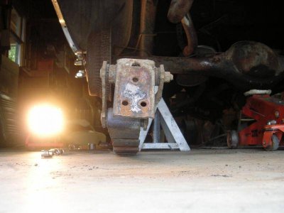

I was removing the leaf springs and 8 3/4 rear axle from my 70 Fury parts car today. On the right side, I made the mistake of trying to remove the strap bolts from the straps with the spring still mounted. As you can see, this, bent the inner strap all to hell. Also, on both lower strap bolts, the nut and end of the bolt broke off when I tried to remove the nut. I realized that I should have removed the 3 mounting bolts for the rear strap assembly and left the straps alone. Thus the left side spring mount looks straight. Given that I am willing to pay for quality American or Canadian made parts, some questions:
1) Where can I buy a new strap assembly for both sides?
2) Any tricks for removing broken bolts frozen in a spring eye?
3) If the spring eye bushing has to be destroyed, where can I buy a new bushing?

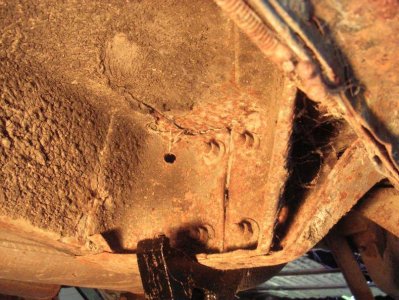

While we're at it, the left side front spring mount rusted out around the bolt head and then the whole assembly shifted inward. Hopefully, I could buy a front spring mount from same vendor. I had to use an exhaust cut off wheel to remove enough of the mount that I could get my 15/16 socket on the bolt head.
