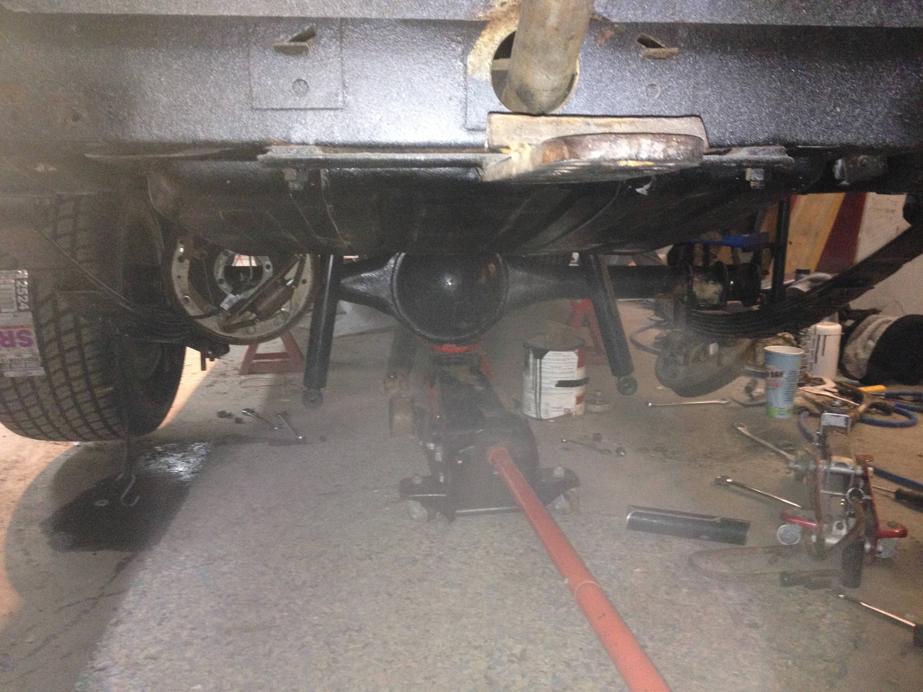

Narrow Diff
b-body differential to give clearance under the skirts for 295/50/15 rubber with 4.10 posi

This is similar to what I did, although I used the offset bracket kit to move the leafsprings over to hit the B-body perches. I mounted 275/50-15 tires on 8" Ramcharger wheels, which have 4" BS, so the extra inch of the wheel/tire ends up moving toward the skirts. Hence the reason for the B-body rearend, it was about an inch narrower each side.
