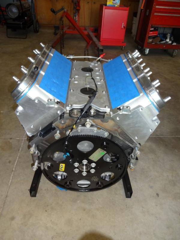

Not much on "little" turbos...... This has been a project of a buddy and mine for the past couple years. Twin turbo LQ 402. Now in the "desconstruction" phase for final finishes.

Type of GM LS style engine, out of trucks I think.
And you are correct, sir.
The foundation of any LS build is an engine block, and picking one that will hit a rock-bottom price point while still providing ample cubic-inch capability is a no-brainer. Look no further than GM's 6.0L iron block, as used in the LQ9 (and LQ4) truck engines. Featuring a 4-inch factory bore and strength to support hundreds of horsepower over stock, this Gen III block is a superb choice for not just N/A builds like our own, but power-adder applications as well. If you're lucky, you can find a used LQ9 block for just a few hundred bucks, or just opt for a new one under GM PN 12572808; major retailers like Summit or Scoggin-Dickey sell them for around $725. Sure, there's a bit of a weight penalty that comes along with iron, but we're saving hundreds of dollars versus going for the comparable LS2 aluminum block--and the L92/LS3 blocks, with their slightly larger bore, go for double the price of an LQ9 block or more!
A killer heavy duty block for $725. New, From GM.
Sheesh.....

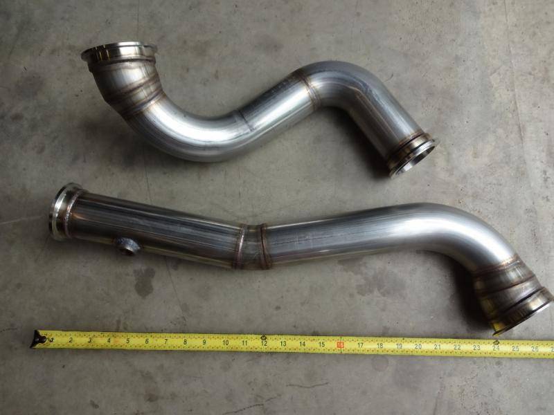

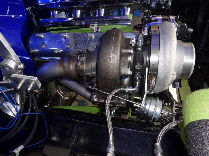

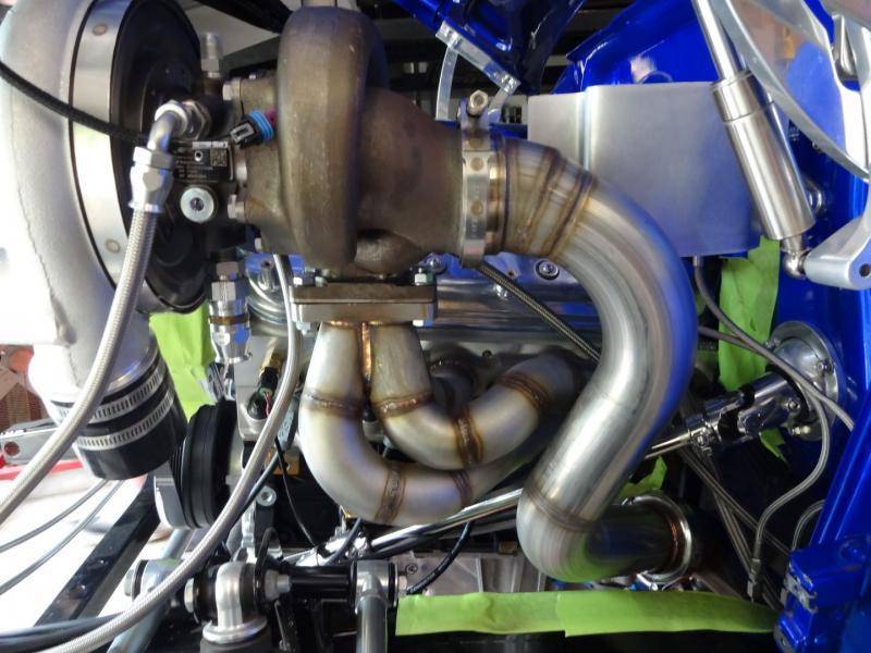

Here is the car on the way to our turbo guy, Tony.
He custom built the entire turbo system, intercooler and full stainless exhaust, using Borla mufflers.

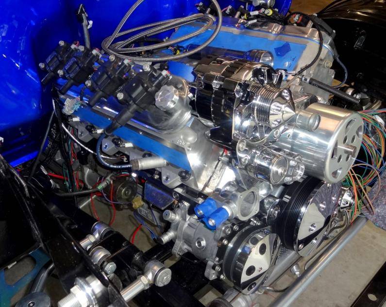

We started the project about 2 1/2 years ago, and it looks like it will be another year to complete yet. Almost everything is hand built and fabricated. Lots of time, patience, thought and design has gone into it. It's not that easy to come up with a "unique" 57 Chevy.
It should be in the trim shop soon. Interior will be "period custom" featuring four 64 Pontiac Grand Prix bucket seats, (custom upholstery), a full length custom built console with a transparent lexon top plate housing the power window switch's and a PCS push button trans shift control. As well as the digital analog Dakota gauges, vintage air, built in sound system etc.etc.
