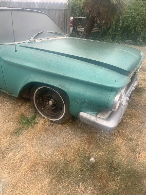

I have a 61 Fury with disc brake conversion.
I have 15 inch wheels on it now
I would like to use 14s with stock hubcaps.
Picked up a set of 14inch rallies that I will be
putting on.
I believe they will work with discs.

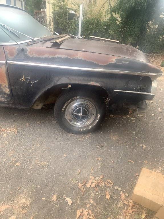

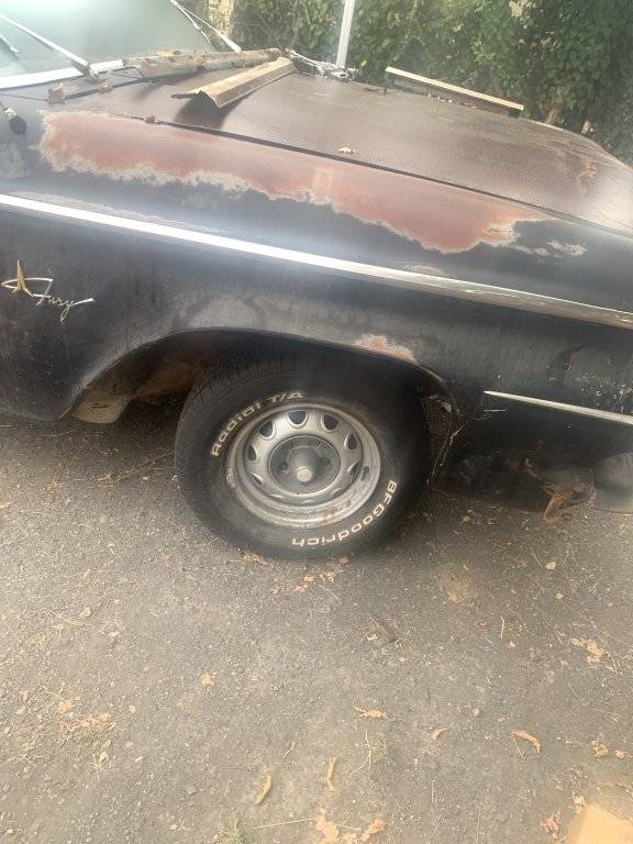

I will be putting the 14in rally wheels that are the drum brake black fury on the 15in green fury disc brake conversion car soon. Will post results

Just updating results of using 14 rallye wheels and or 14 in plain disc brake wheels from a volare.
Unfortunately neither one worked?? Wheel would not clear calipers.
Next I will try some stock 14 inch rims from from a disc brake 69 coronet wagon.
