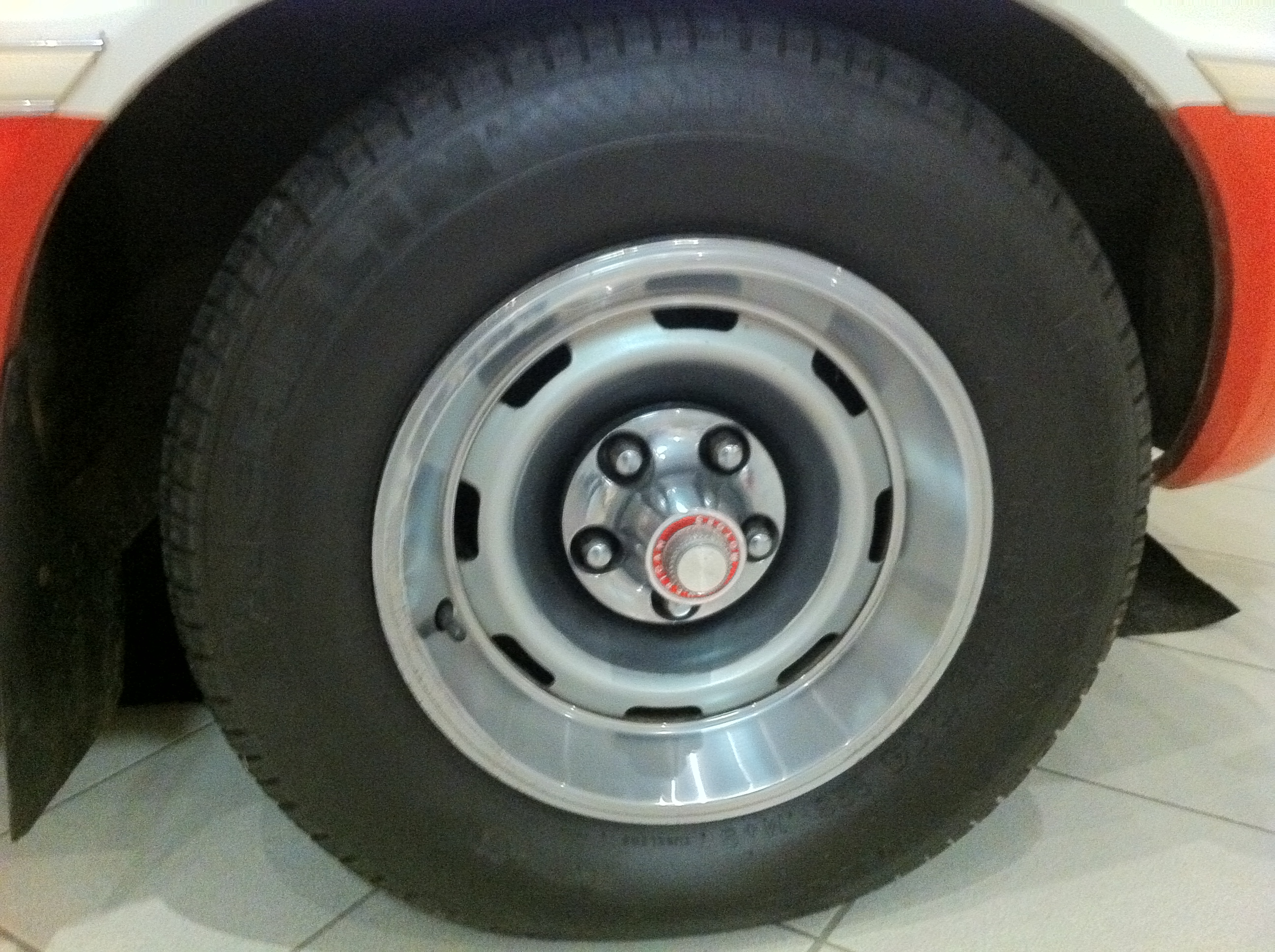

Looks like the same wheel as the ones used on the Aspen Super Coupes etc.
Mopar cop car wheels. Same wheel except for the "nubs" for the hubcaps.
Super coupe wheels were 6 slot like the cop wheel w/o nubs ... the AMC ones above are 8 slot with no ridge around the center

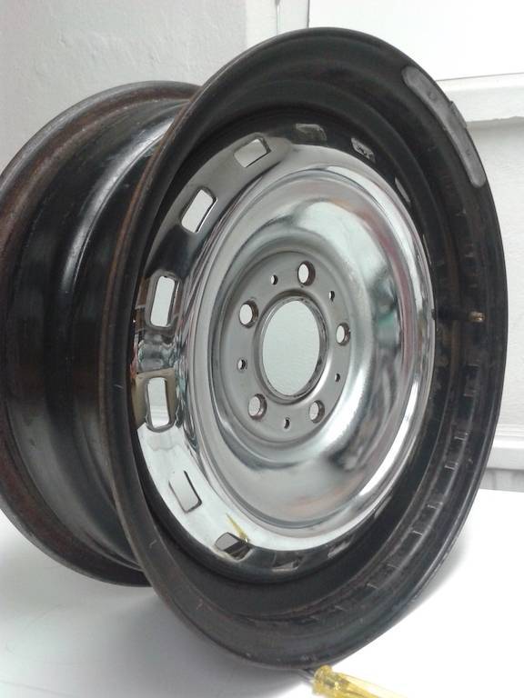

Back to the subject:

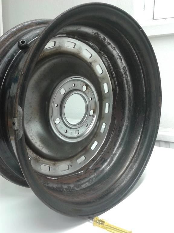

The Chrysler Road Wheel consists of a painted outer ring, and chrome plated inner part, which has been welded to the outer ring. The welding beads are about 4" each, and there are four beads at regular intervals. It is indeed possible to separate the ring, and the wheel proper, and replace the wheel with a wider one, or with a wider AND larger diameter one. It has been done, and I found two companies doing it over here on a regular basis. Just sent them inquiries for a quote. - I'll report on this shortly.

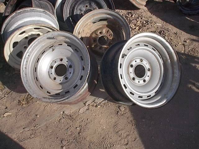

Those GM pickup wheels, yes, have a different BP and are not usable as-is, and I abhor adapter plate also. I believe these wheels also have an extra pronounced ridge in them just inward of the 16 slots, although it's been years since I saw one in person. (I think I see it in the pics in an earlier post)
